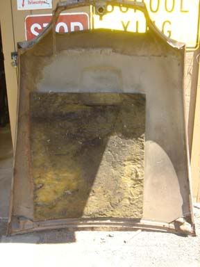

            Here is a photo of the underside of our '63 Hawk hood. I assume it is original. Note that is is not centered, but away from the battery side. The underside is body color.
            Perry

                The new mat I got from SI is a lot bigger than the one in the photo posted by fpstude. Thanks for the photo by the way. The new mat is big enough to cover most of the bottom of the hood. Is there any reason why I should not let it go full width? What was the reason for off setting the original away from the battery? Clearance?

                    I agree with the photo in post #6. On Hawks, 63 & 64 for sure, have the fibreglass side toward the engine. My '63 Canadian built GT was that way from the factory. I also have a NOS hood liner for a GT hawk with A/C. The cutout for the compressor pulley dictates that the fibreglass side goes toward the engine. The Larks appear to be opposite to that in liner placement.
                      As can be seen on post #6 photo, the original hood insulators were yellow colored fiberglass, not grey as the SI ones are.
