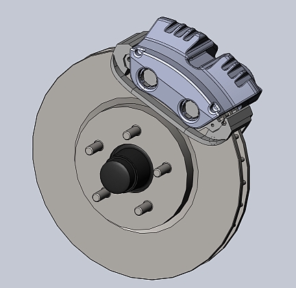

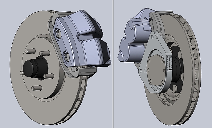

              First version of the PBR caliper and 13 inch rotor.
              More detail added to the PBR caliper.
              Tom

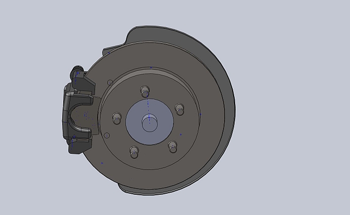

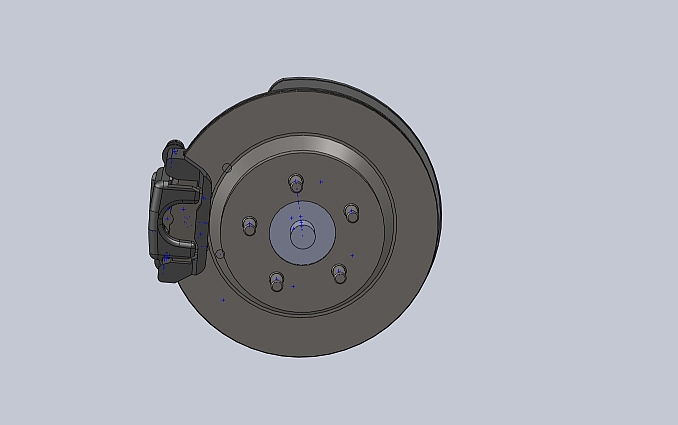

                Pulled apart the rear brakes on the Avanti to measure and create 3D models of the GT setup. I am
                also researching the Cobra rear setup parts to order and create mounts that will accommodate both
                setups. Seems possible.
                Tom

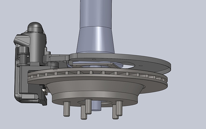

                        The brackets I have on the rear of my Avanti are modified Ford parts, they simply bolt onto the
                        inner surface of the axle tube flange using 3 of the 4 bolts. The hub is the same one the drum
                        is mounted to. I pressed out the studs and drilled them just like the front hubs and used those
                        same shouldered studs to center the rotor. The only thing that I found was over the years the
                        rear hubs get distorted from the forces generated pulling the hub off the tapered axle shafts. I
                        had my hubs put on a lathe and just cleaned up on the front face. This is not a requirement, I
                        also found that a solid blow from a short sledge will move the hub face a tad to fix runout issues.
                        Cobra rear rotor is 11.65 inches and it is vented, while the GT is 10.5 and solid.

                          Cobra/Mach1 Caliper Bracket added

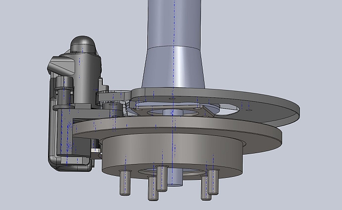

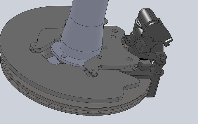

                          I ordered the Cobra/Mach1 caliper bracket which allows the use of the 11.65 inch Cobra rotor to
                          be used in the design. The setup in use on my Avanti for years now has been the 10.5 inch GT
                          rotor and caliper bracket. Ford used the same hydraulic caliper, but changed the pads, rotor and
                          mounting to fit the two different versions. The plan is to make ONE bracket that mounts to the
                          Dana 44, but allows either setup to be installed. Here are the preliminary Cobra additions :
                          And a view of the Ford parking brake setup, which actually works with the stock Studebaker pull
                          cables already on your car.
