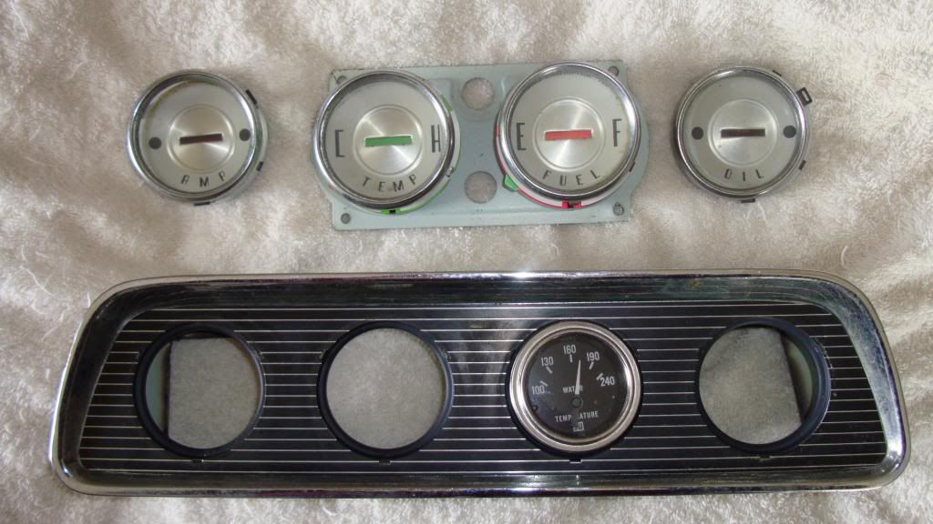

    I am replacing the original gauges in my 1957 President Classic with "classic" SW gauges similar to those in the 56-61 Hawks. I want them to match each other and be as close to what was in the earlier Hawks as possible. I cannot find a matching mechanical oil pressure gauge, but there is an electrical gauge and sender which looks very good. I have already received an temperature gauge and the ammeter and fuel gauges will be no problem. I will probably sell the original gauges to someone in the club, although I don't know if they work. They do look nice. Has anyone had experience connecting and using the electrical oil pressure gauge?

        Thanks for the suggestion. The problem with the gauges from the Hawks is that they require the reflector boxes for illumination and I don't think these boxes would lend themselves to the horizontal in-line arrangement of the gauges in the '57 sedans. I need drop-in gauges which have their own light source. It might be possible to cut a hole in the back of the gauge for a light, but it might interfere with the gauge itself.

            Jack did you notice that Dave's '57 Parkview Wagon has the original Chrome Bezel (rings) to properly fit the Hawk Gauges in the larger holes in the panel?
            I think when Chuck Potter put those in there while he owned it for a couple years and restored it before I bought it back, he must have destroyed the originals to get those bezels.
            He then modified the light box as needed to mount the gauges and give enough light to the side windows of the Gauges.
            But if the new Gauges have no windows I guess you can't do that.
            It's a bit late now that you have New Gauges, but I would have used Jack's and Chuck's method.

                Good suggestion, Rich. I have the original instruments and bezels as pictured above, and the new S-W gauges will fit well inside the bezels, although they look almost as good without them. I don't suppose anyone would wish to buy the old instruments and bezels, and I don't have any idea whether they work or not, they probably would if the senders are correct. Both the old temp and fuel gauges are S-W, so they are probably just as good quality as those in the Hawks. The amp and oil gauges are just "idiot lights". I don't know why anyone would want them unless they are authenticity freaks. Who would try to restore a 57 4 door sedan unless they were idiots like me?
                I'll bet if you remove the back of the housing for the gauges in Dave's wagon you will find that it had to be extensively modified to fit in the reflector boxes, which would also require a lot of drilling of holes to mount the gauges horizontally, as they were vertically mounted in the Hawks. And the lighting of the gauges through the slits in their backs was never very bright.
