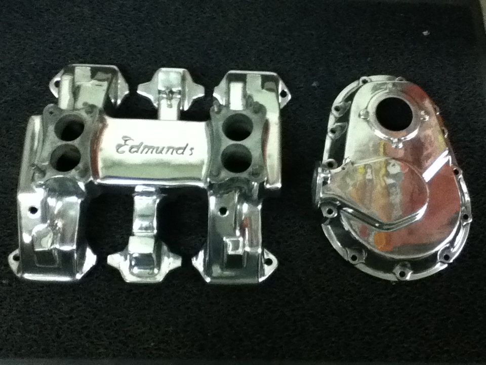

          Here is the intake I have on my 259

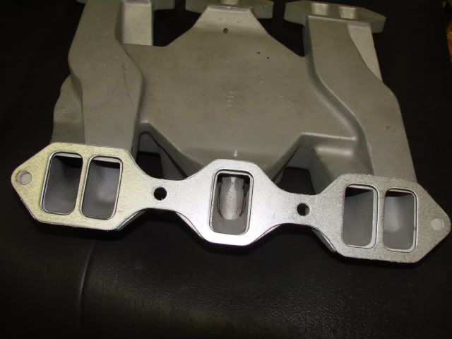

            What ya puttin it on? Here's a Offy with gasket to give you an idea of the ports.
