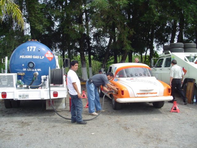

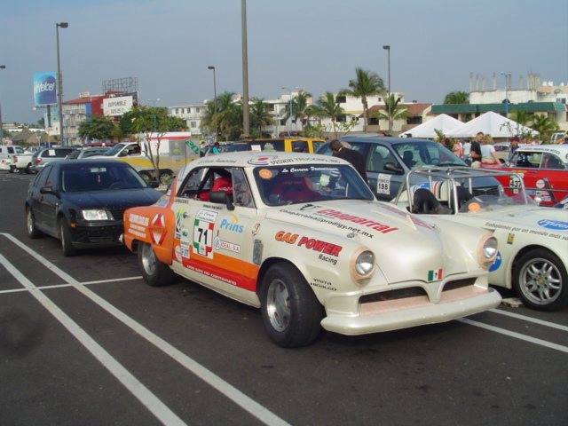

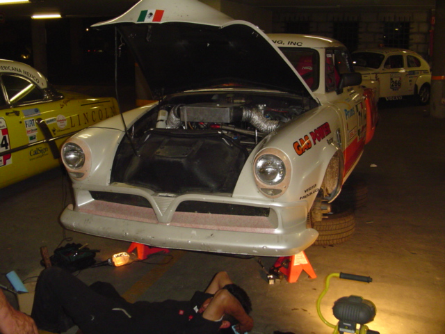

    Greg Meyers is planning on running his Tri-Baker on propane. This is the same turbo-charged Champion engine we set records at Bonneville with. You can read the extensive blog on this project here:
    http://tribaker.wordpress.com/
    The last time I ran at La Carrera (2006) there was a Studebaker running some sort of LPG/Natural Gas/Propane setup:
    That is as PROPANE (LPG) as it GETS! No CNG there.
