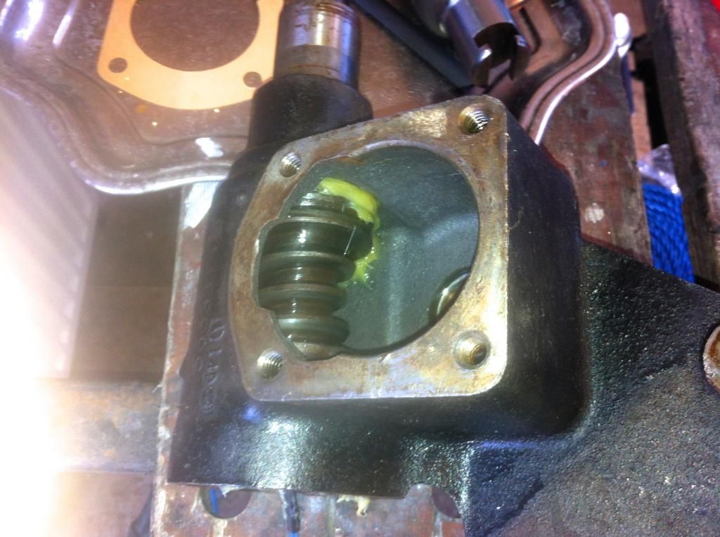

    Hi guys, new bushings installed, new bearing, seals and gaskets. Job's a good'n

    I had a thought, as the steering gear is a ratio of 20-1 any play in the steering box magnifies this problem 20 fold at the wheels, where as 1/16" of play in a control arm shaft would be just that at the wheels. Is my thinking correct??
    Anyhow, new outer upper control arm pins were needed. I'm just waiting for the steering shaft bearing and a couple of other small things and the steering box can go back together.

    Hey guys, steering box is out!
    We took the seat out, disconnected the wiring and pulled the box through the firewall with the column and steering wheel attached.
    I then disassembled some of the steering box and found worn bushings, worn tapered bearings and a broken horn button. the pitman shaft assembly seems good.
    Should the lower steering shaft bearing have this protruding part of the race? The roller in this area fell out, all the other rollers stayed in place, thoughts? The tapered bush it rides against is scored.
    Does anyone know where abouts the shims are that i've heard so much about? And what box do I have? I presume it's a Saginaw? Is that TL??
    Thanks for everyone's help, much appreciated.
    Cheers, Aaron
