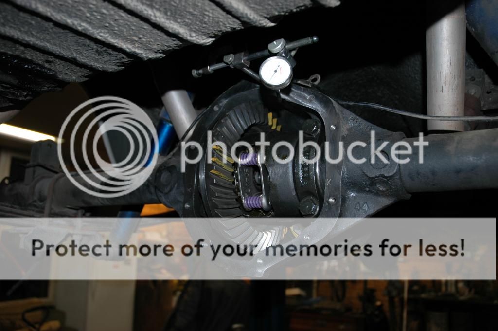

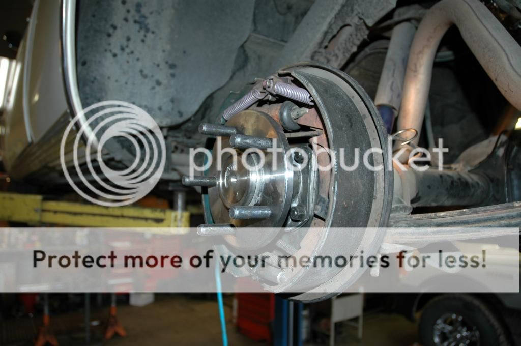

    Its not at all that difficult. I went the other way: 3:73 to 3:31. Installed Mosier Flanged axels from Fairborn, dropped in a Auburn Possie, Shimmed it all up the right way, i.e. both sides, and on down the road we went![IMG][/IMG][IMG][/IMG] Just a couple of hours on the lift.
