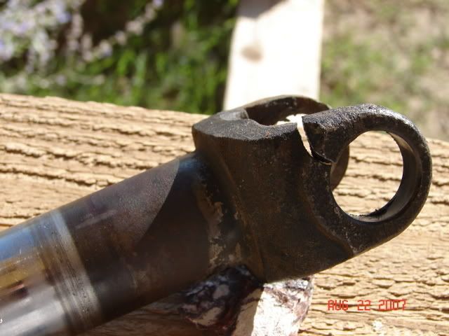

              All I can really say about this picture is
              that it was a bad day for egg lovers....it
              appears to be a "broken yoke"

                A testimony to check those dry U joints, probably were not checked once since they left the factory.
