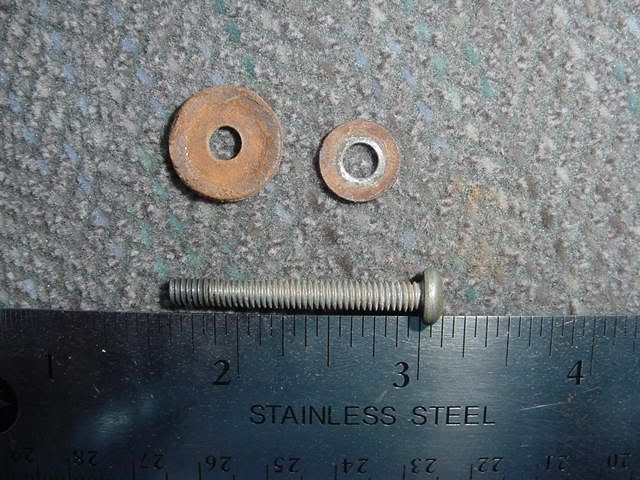

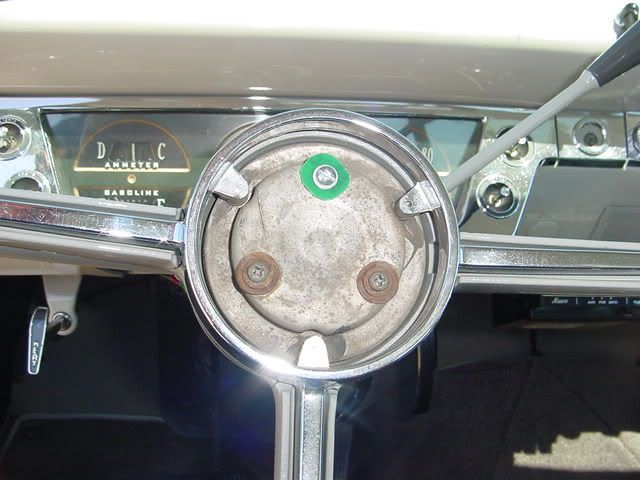

        So happens I drove my '53 to work today so I went out and took some pictures of them. I believe the 56J type "E" wheel has the same horn ring as the '53 (I got the one in my car from a '56 sedan).
        Don't forget the fiber washer! You can see in the top picture I lost one of my screws someplace and had to make a insulator from a scrap of circuit board. The bottom picture shows the fiber washer on the left and a steel washer on the right that goes on top of it.
        Hopefully this is what BB is looking for.

          Exactly...... wonderful. Got the horn ring on and it works. Pissed off my dog and the neighbors getting them aligned.
          Thanks
