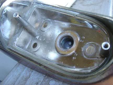

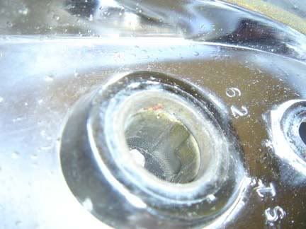

    The tail light housings on our GT Hawk need to be rechromed. The bulb sockets need to be removed. There appears to be a ring pressed into the socket from the bulb side. Can the sockets be removed and reused, or are new sockets needed?

    They are probably the same as my speedster's tail light housings. It has sockets for the bulbs, that are pressed in. To remove the old ones, I pulled with pliers, gently pounded with a hammer and small screwdriver and they eventually popped out. Then what you want to do, is get brand new ones after the chroming is done. The new ones press right in and work much better, since the base and wires are not corroded. What I did was I went to NAPA and asked to look through their catalog that has bulb sockets (you may need to befriend them or find an older guy that understands you're looking for something unique. Hopefully your local NAPA hasn't thrown out the catalogs, most keep them in back now days). They have dozens of sockets in the cataloge, look for the same size with the same number of contacts and with a push in bulb style...just match it up. Well worth it, they're not very expensive, work good, and the lights will be brighter.

        The old sockets can be removed by careful prying. Remember they are installed in pot metal castings, which can be easily damaged beyond repair.
        New sockets should be available from your local parts supplier. They probably won't have them in stock but, if they don't have a catalog for you to select from, you need a better parts supplier.
