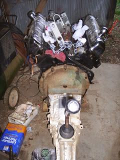

    My brother put a T-5 out of an S-10 into his 57 Transtar. The 5 speed makes the truck much more highway friendly than the truck 4 speed that was in it. The S-10 version of the T5 is usually needed in a truck because the shifter is far enough forward to clear the seat. The Mustang version works well in a car and there is an adapter to bolt it to the Studebaker bell housing. Some of the Studebaker truck bell housings can be drilled for the T5.

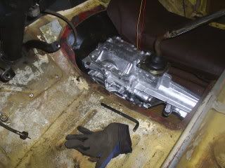

        I put a GM T-5 (it's longer that the Ford and put the shifter where I wanted it) behind the correct GT Hawk bellhousing in one of my Studes in the mid-90's and never looked back. It's still working fine and running with a 4:09 TT rear and the overdrive are a delight!
