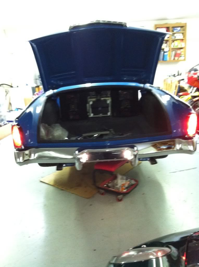

ID:	1675914Here is the underside of the trunk lid of my early 1953 Commander Starlight Coupe (Tri-star trim).
                    I hope that this will help you.

                        Who is this guy inspecting the trunk reinforcement in my 53? LOL
                          Big fat dork.....
