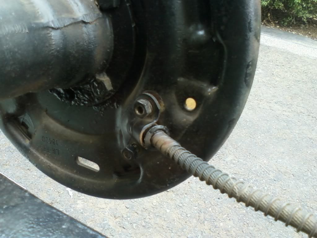

    I need the rear cable for my '53 Commander Hardtop so I looked up the part in the chassis parts book and got the correct part number. Called SI and they have that number so I ordered it. The cable looks right except for the end that goes into the backing plate. Mine is held in by a clamp with two nuts and the one they sent me is held in with a clip. I tried and it will not work. Does anyone have any idea? I called SI and they have no idea.
    My set up
    SI part
    You have a '54 and later type backing plate installed on your car.
      The cable I ordered is listed in the SI catalog as '54-'64 C and K cars and in the '53 chassis book it says '53-'55. It's part # 533065. The '53 manual shows a good picture of the set up I have.
