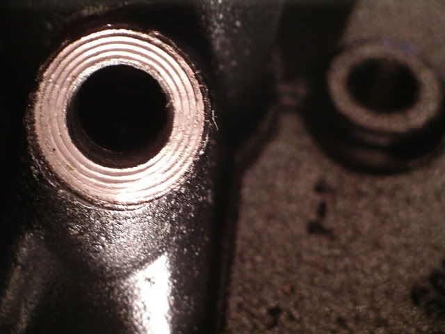

    After re-looking at the bottom mating surface on the newest hydrovac and JP's observation of some his cores being rejected. I want your opinion as to whether I should install this newest hydrovac.
    Here is a picture of a really good mating surface
    Here is a picture of the leaking hydrovac. You should notice the blurring of the ridges at 1:00 and 7:00 o'clock of the picture

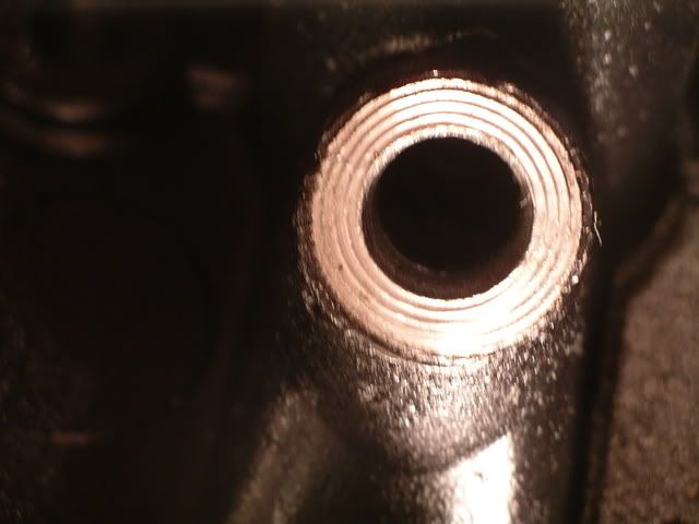

    This is a picture of the newest hydrovac which is suspect also.
    I really don't like this newest hydrovac and think I may have problems getting it sealed.

    They don't look that bad. Make sure you are using soft, new, never used soft copper washers and crank them down real tight.

      Thanks John, The pictures look better than in reality. The ridges are quite flattened at 8:00 oclock. I'll be painting my inner fender first then I'll give her a go with the two different sized copper washers I bought from SI as well!

        It's hard to say from the photos, but they look as good or better than the one I got. I reiterate the above.

          It seems that it would be possible to mount the part in a lathe and
          remove and then re-form the grooves. No??

            Tom, I expect those face grooves were made by some sort of piloted end mill. I wonder if a suitable mill could be made from a high-speed steel router bit? Cast iron is pretty easy to machine.
