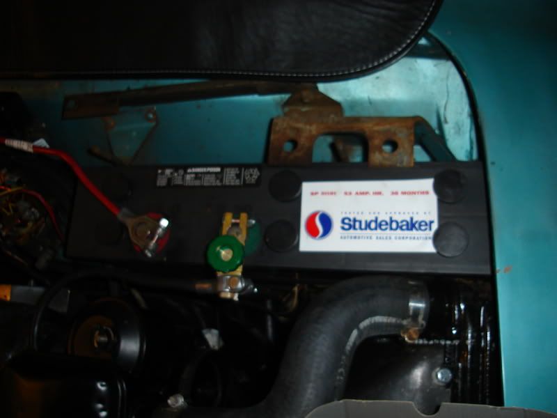

          Had to get a battery, 3EE, for my 63 Avanti a few weeks ago. Kanter in Boontn NJ wanted $139 for no script & $239 with script.. Went to an interstate battery distributor. Paid 79 - 12 for the core = $67..Purchased a Studebaker battery label from Stu Int for around $3 and stuck it on top...Could get a Willard label for about the same & slap it on the side..

                        Here's the Interstate 3EE I put in mine with a slight modification
                          Only the 63's used the 3EE, if you have a 64, it uses the group 24.
