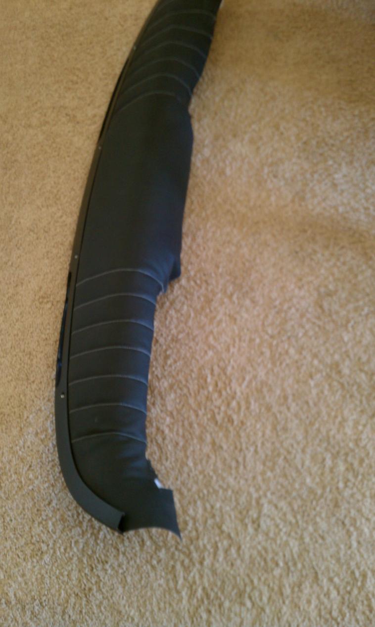

                That dash Pad IS the Original and very rare in even that condition, only '60 Deluxe Cab Champs had those. I would use it as a sample pattern.

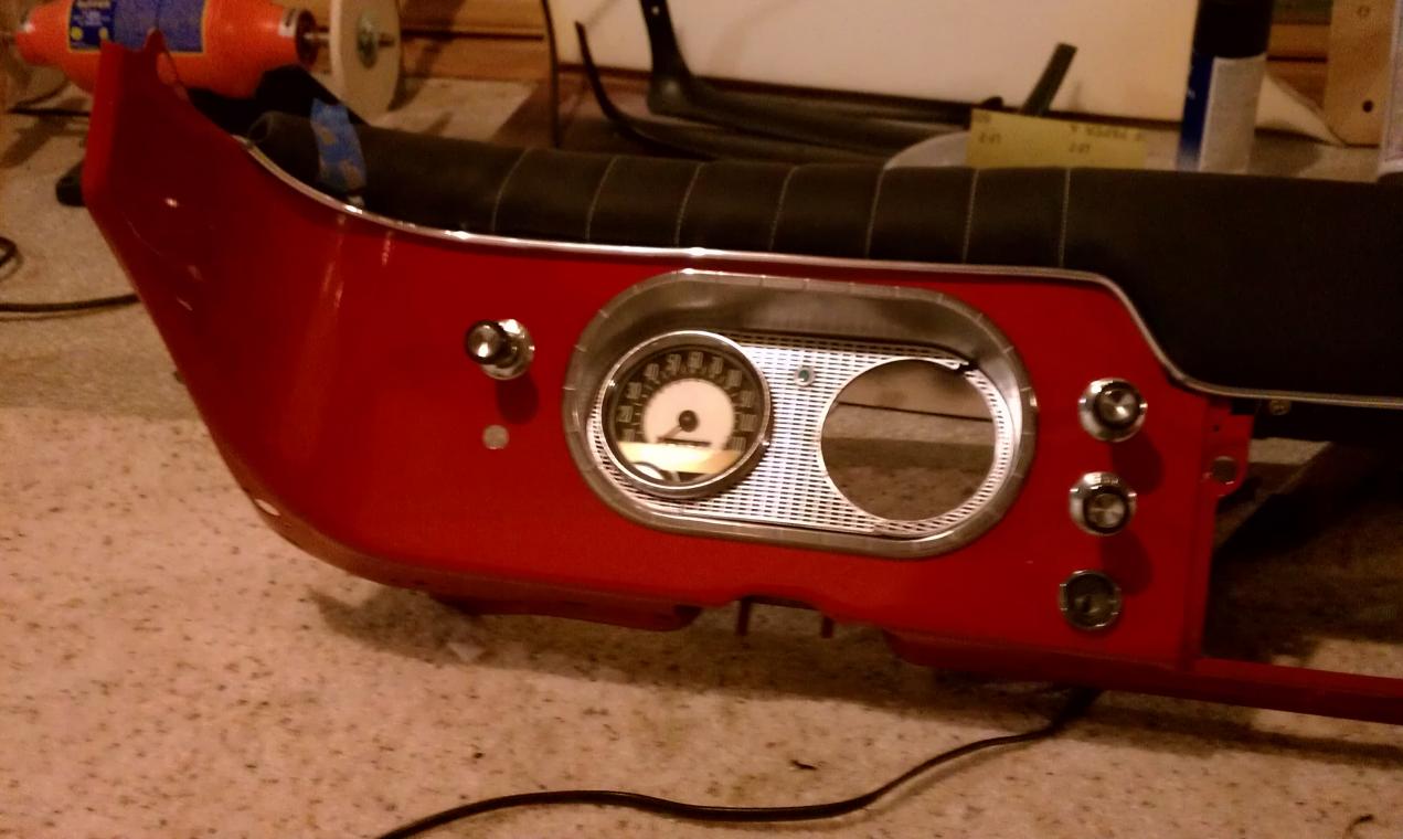

                          OK, I listened and pulled the dash. Very good decision.... oh the dirt behind it that needed to be removed! It will now be so much easier to re-trim the firewall and repaint the steering column too.
                          Finished my top cover and attached it to the shell. I used too heavy a backing material behind the batting so the contour it isn't as smooth as I wanted. I need to back track and get it right.
                          Today's objective, get the dash painted. My local NAPA store will mix and rattle can color code Acrylic Enamel, so I had them mix a couple spray cans of Apache Red. I've gotten in the habit of doing this for touch up or places that got missed like around door jams, firewalls, inner fenders or wheels so I don't have to make a major base/clear coat project out of small jobs. This paint is a initially a bit softer than a catalyzed paint so it needs more time to harden out.

                          Now, I'm looking for an answer... How do I get those pesky buttons off the controls so I can remove them and paint the dash?

                              Refreshed the instruments and buffed out the trim rings. The gels in the idiot light holes are shot so today I ordered colored 1/4" LED's to replace them. I plan to mount them in rubber grommets to hold them in position in the light holes. The more I looked at 62Champ's Pics, the more the dash needed Chrome instead of a white piping like I had earlier proposed. So, I picked up a roll of chrome door edge, placed folded scrap vinyl in the groove over 18 gauge upholstery thread and used this instead of chrome piping. Applied a little hairdryer heat to soften the bends.... came out great.
                              Painted the dash and buffed out knobs and backing plates. Placed another layer of batting under the dash mat and it made a big difference. Tossed the radio.... if I add one it will be below the dash.
                              Pulled the arm rests to re-cover and was shocked to see how close the original fabric was to the fabric I used to upholster the seat, door panels and now the armrests. In the AM hope to pull the steering wheel and begin restore on it.
