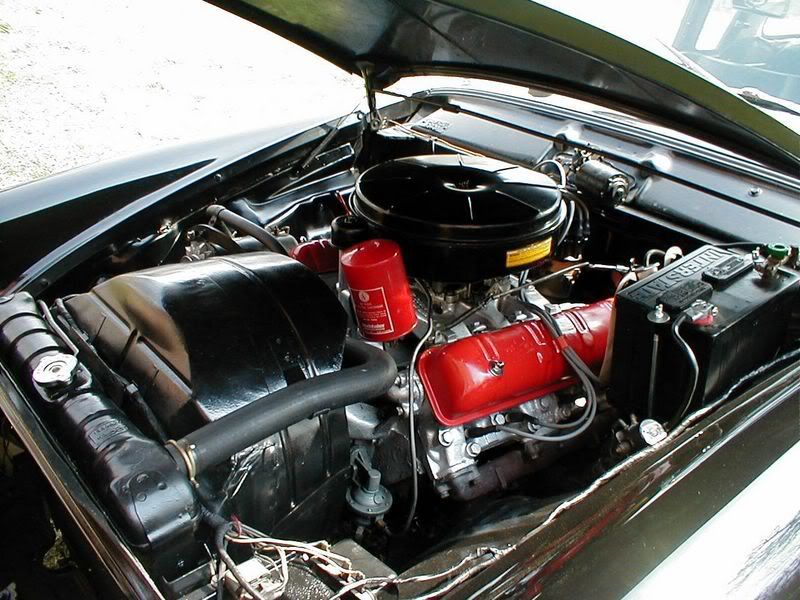

      [img=left]http://www.alink.com/personal/tbredehoft/Bothcars.jpg[/img=left]
