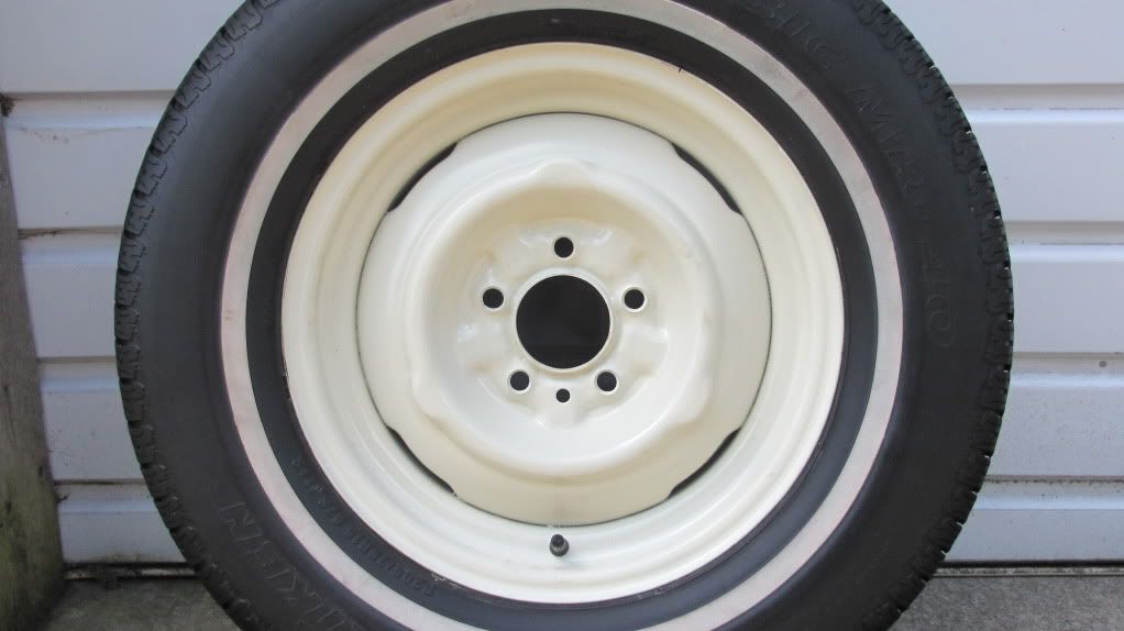

            Here is a stock Disc./Non-Disc. Budd wheel as used on most '59-63 and '65-'66 Models.
            However, it IS possible that some '59-'62 Wheels that LOOK just like this '64 Drum/Disc. Wheel, do not have enough clearance in the back for the Calipers, but not ALL of this type. It never hurts to check it.
