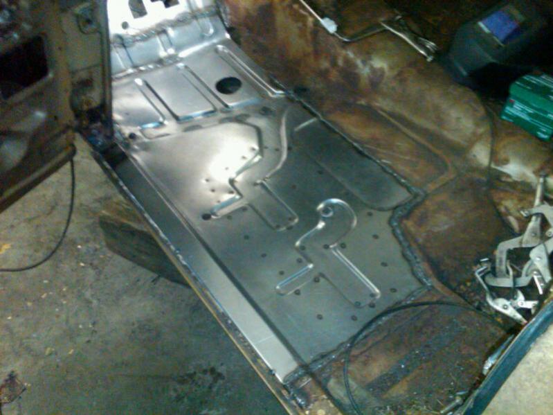

            Here's a pic of my 57' Golden Hawk being raised from the dead!
                  Is the replacement floor pan in your picture from Classic Enterprises? And how would you rate the product and the fit?
                    Brian
                    Brian,
                    Yes the floors and every other sheetmetal part we replaced so far is from Classic.
                    I rate the product high and fit was great.
