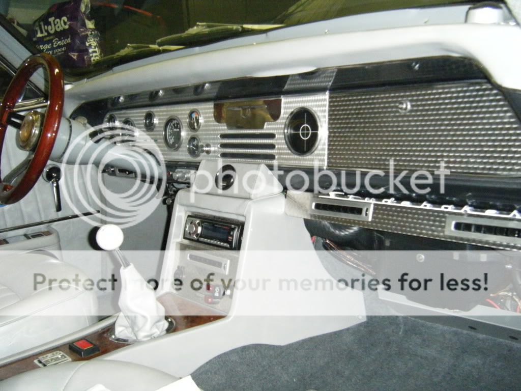

    I'm in the process of putting a space saver Vintage Air unit in my 66 and it's a bear. I even had to cut a piece out of the unit to get it to fit the floor (but I do have a custom trans tunnel though). I plan on doing some sort of "knee bar" to cover part of the unit up under the dash. Even though it looks like the unit is hanging low, it still takes up most of the glove compartment. I'll have to make some sort of custom insert eventually. If I didn't have a custom center console, I would probably have gone with an underdash unit.
