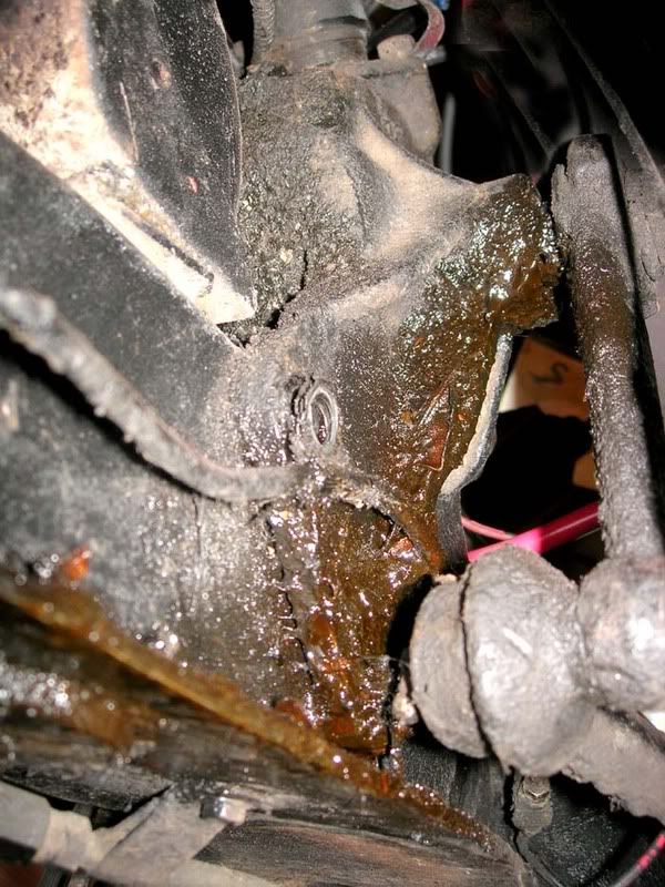

    I am so ready to put the front clip back on my 52 Commander, but I have one last PITA repair to do. The Ross steering gear box is leaking fluid bad. I have bought a new seal and gasket from SI. I also have the shop manual, but it says that I need a special tool to get the pitman arm off. Will a tie rod separator tool do it?

    Leonard, is there a nut or bolt missing from the brake line clip at the base of the steering box flange?
