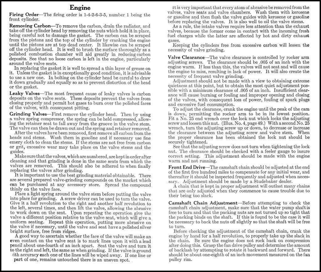

    I'm a new Stude Standard Six owner and need to sset the engine valves. The problem is that I don't have
    the proper data about the play to apply. Could someone give me this information. Thanks in advance

    JJ; Two pages from the 1925-26 Model ER Owner's Manual re valve adjustments and settings above. The manuals are 64 pages. I believe I have an extra, let me know if interested.

        The .005 dimension above becomes .127 mm if that assists you. That is the smallest acceptable spacing.
