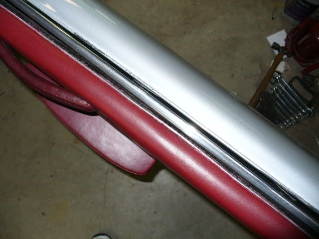

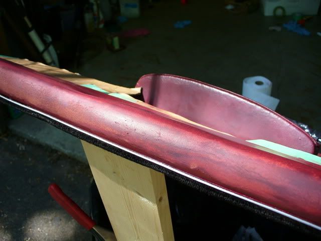

    Here are a before and after shot of the upper door panel. The color is way off due to the flash but it is a gorgeous deep blood red on the car.
    Before
    After
