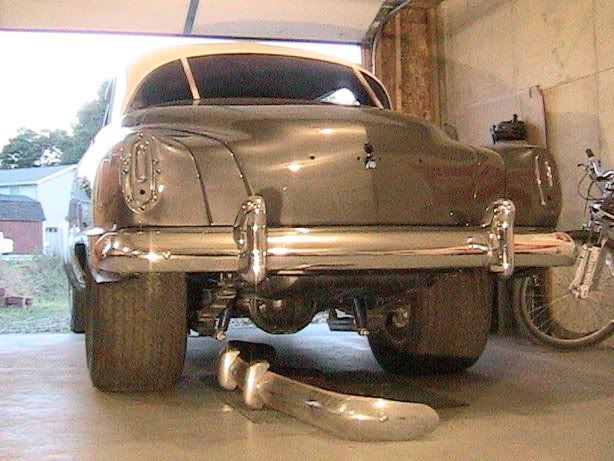

    I wanted to post this picture just to show the wider tires under the 47-52 shell. This is far from a full-on race setup. In fact, outside of the Ford rearend its pretty much all Studebaker. Simple leaf springs and slapper bars. That is all Studebaker frame under there, along with an added support to act as the upper shock mount. The stock gas tank fits perfectly in between the narrower frame. (Just don't go any narrower than 11 inches.)

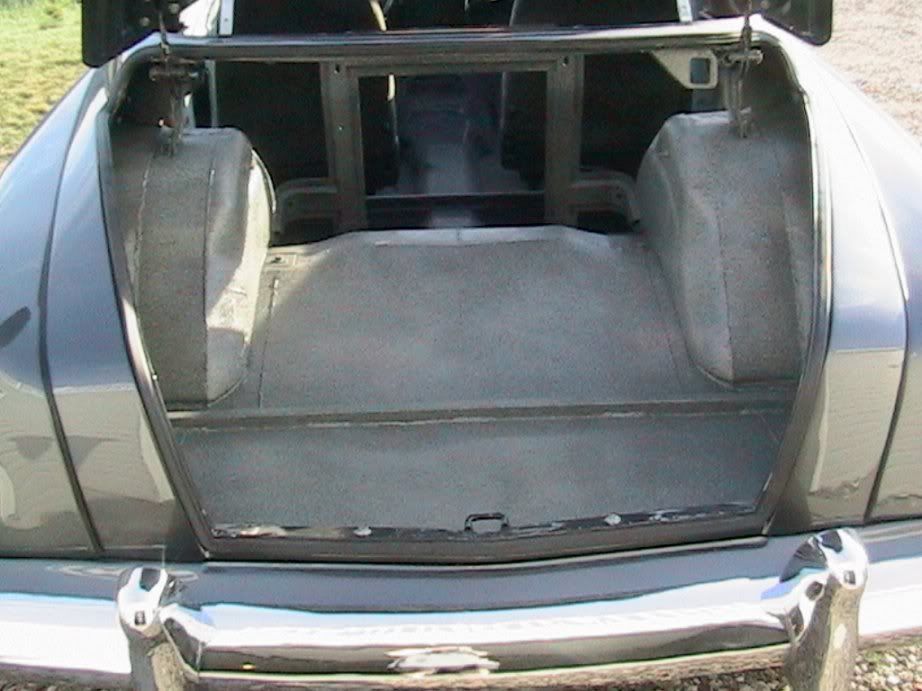

    The trunk floor and spare tire well was a big rusted mess anyway. New metal here, but the original wheel wells are just relocated in. The back seat supports are all there and the back seat will fit with no trouble. Because much of the stock floor moved inboard too, the body mount holes still lined up with the frame holes.
    (The Ford rear was not a must in my book like some figure. I just got a screamin deal on it to good to pass up.)

    How did you narrow the frame?
    Did you splice it?
    Are you running a roll bar and braces to stiffen the frame?
    Just curious.
    Looks nice under there...
    Jeff[8D]

        The frame was just sectioned and welded back. I figured out how much more tire width I needed, doubled it, and hacked it out of the middle. Pretty simple. I only briefly considered a fancier 4 link or other such work. Realistically, this Stude will pull simple double duty as a bracket race car and occasionaly car show. I'm not going road racing. And a lot of guys go quicker than I will be going with leaf springs.

        Here is the piece you need to make with your floor. Remove what is in between the black lines.
