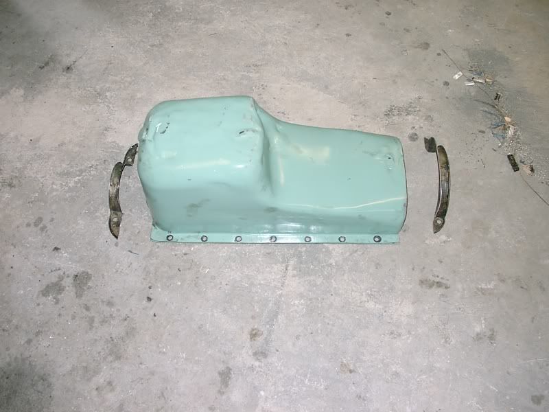

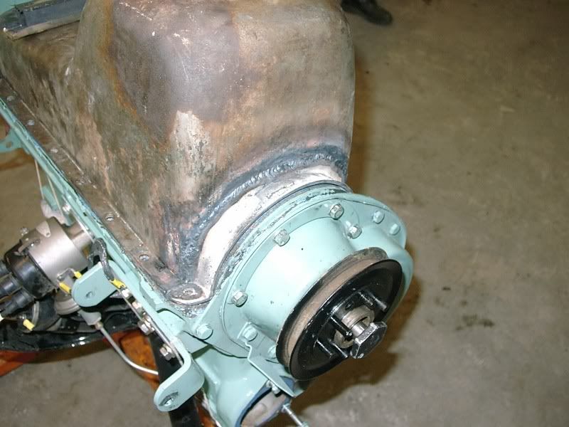

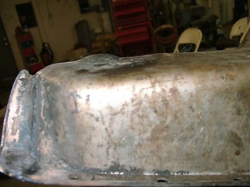

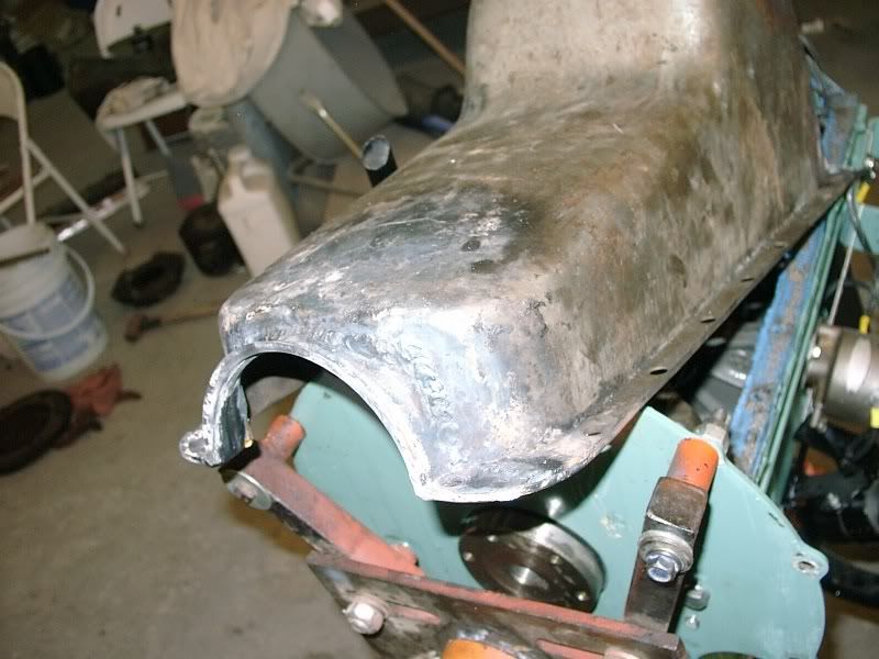

      The Green oil pan came with the 1955 185 engine. The other pan is off of the 1949 170 engine. Had to cut the front and rear off of each pan and weld back together. Also had to remanufactur the front motor mount. also had to cut off about 1/4 inch off of the fan blade. Any questions just ask.

        Wow!!!That's some nice work. Thanks for the pictures
          What engine are you installing? A 185? And you can't use the pan that came with it because it hits your steering links?
