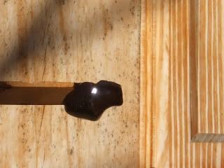

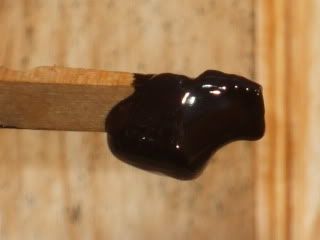

    Hi, had a chance to tinker with the truck some more today and decided I would change all of the fluids including the trans grease. When I pulled the drain on the trans nothing came out. Further investigation revealed the trans is pumped full of what appears to be a chassis grease. I am hoping this is a product I am not familiar with but as you can see in the pics this stuff will hang on a stick. I am guessing it was put there to overcome or hide a problem. there was a hollow made at the fill plug which I had filled with gear oil but it wasnt very much. Would you assume serious damage in 2500 or so miles of driving with this concoction? This is the truck that jumps out of 4th gear. My trans says T-98 IV on it, Is that a t-98 or T-98A? Thanks, Steve

    Does not look good to me... [:0][xx(]
    I would likely be pulling that baby out and taking it apart for a good look see to find out for sure what is going on. Usually something around 80-90 weight oil in those units.

      Yes, I will be pulling it before I drive it any more. I had hoped to get a junk 56 truck for parts but wasnt able to put together a deal on it. Ive never taken an auto transmission apart but have built a few for motorcycles, How hard/expensive is this trans to build? Does it require a lot of special tools? Thanks, Steve

            It does look like somebody used chassis grease in there.
            I got my GL1 for my 64 Champ with the T-98 at the local Tractor Supply co.
            It was labeled as tranny oil for older Ford tractors(Jubilee, 8N, etc).
            I filled mine and ran the truck around the farm for an half hour, drained it and filled it back up. The transmission shifts as good as new.
            It was a little balky on the old stuff that was in there.

                When I went to change the rear gear oil in my 62 Hawk, at 108000 I removed about 1/4 cup of gearoil. The rest I had to scoop out by hand, a might thinner than your examples. I sprayed out housing with brake clean, allowed it to dryout overnight and refilled it. Did that again after 200 miles. My car was a Calif. delivered, was the oil ever changed? Did heat, ambient air temps help cook the gear oil? That is my guess. Lou Cote [8D]
