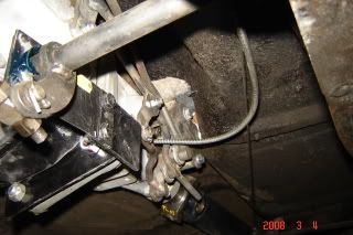

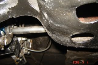

    I'm putting a T10 in a '60 Lark. Has anyone here done this and if so, how/what did you do the mount the clutch operating shaft to the transmission. I have a bracket that came with the transmission but it appears to be one for mounting it in a Hawk and places the pivot too far forward. A picture would be great if possible.

    If it is for a convert it is alittle harder.

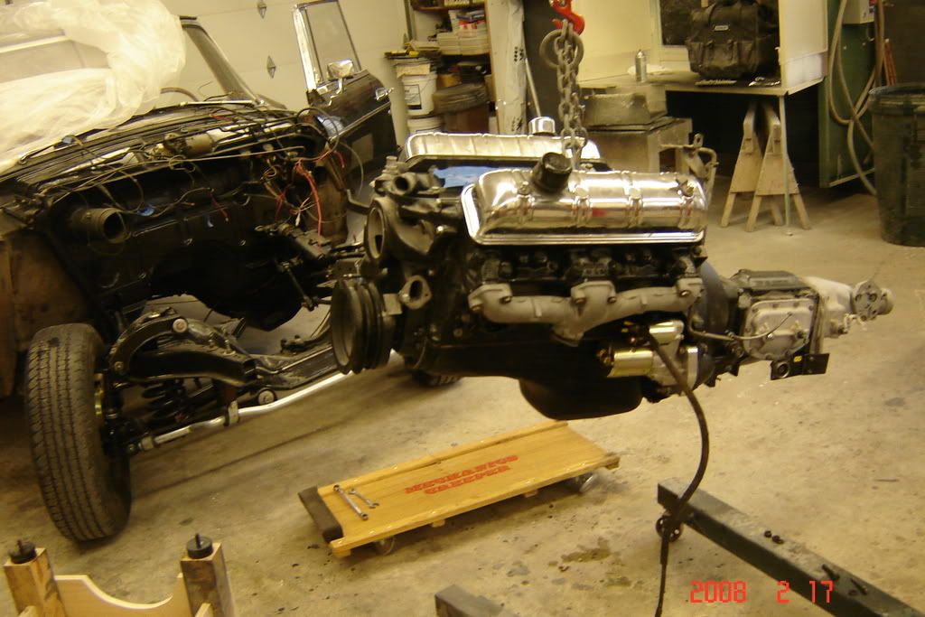

    I put a t-10 in my 59 ht.
    I used the two bottom bolts on the tail housing to secure to the tranny.
    The clutch operating shaft has to be shortened.
    Because the t-10 is wider than the 86 .
    the distance can be figured out on the bench if you have a spare bell housing,I was luccky I had the engine out with the t-10 on it
    and the 86 with the pivot bracket on it.
    he shifter I used was a hurst comp 63-66-chevy
    I had to cut the shifter and bend it forward to keep my benchseat
    Hope this helps

      Great pictures, Joe. Where did you get that starter??

        Thanks! Exactly what I was looking for!! This is why I love this site so much!! Where else could you find info so quickly. I'm glad you had the photos on hand.

        I was wondering what starter you are running and where you got it?

          The starter is a fairborne studebaker
          High torque starter.(220.00 plus shipping
          Call phil harris .
