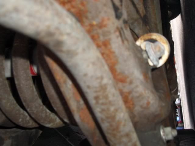

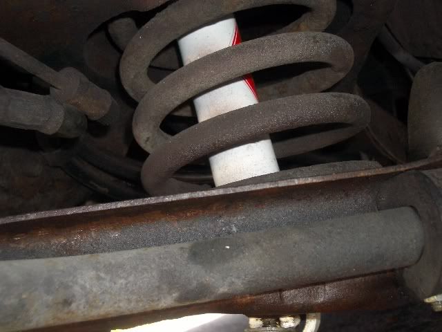

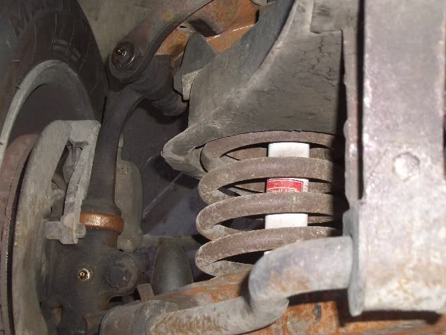

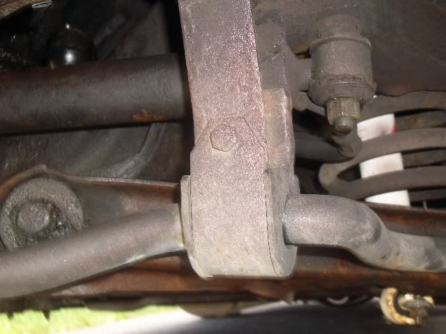

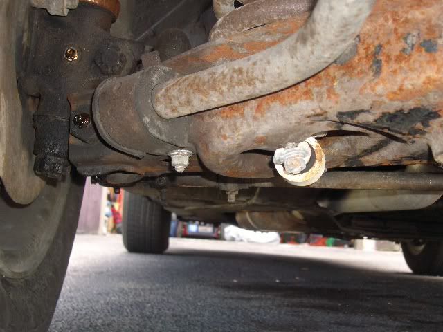

    Well, I crawled under the 78 Avanti II and shot these pics looking for the Spacers under the front springs so I can determine how many to remove to lower the front about 1 1/2 in. I see no spacers. Any ideas gang ?

    Jerry, I think that the spacer is located inside the spring pocket of the lower control arm - not seen in your pictures.
    To safely remove the spacer from under the spring place the car in the air on jack stands under the frame, position a floor jack under the lower control arm, remove the bolts where the control arm attaches to the frame, lower the jack to relieve pressure on the spring. Note: you may be tempted to detach the lower control arm where it attaches to the wheel spindle - doing so is a mistake because you lose the mechanical advantage of relieving the spring pressure safely.

        I agree. the spacer is in the spring pocket under the spring. My 64 even had one. I believe that they are 3/8" or so.

            My "63 w/AC has the spring spacers in the pockets. Left them there when I installed new springs in '76.

              From your pictures, I am more concerned with getting the front end components properly lubricated. I see fresh grease on the Zerk fittings, but I do not see any coming out of the areas that would indicate that enough grease got through to do the job, like on the king pin thrust bearing/washer.
