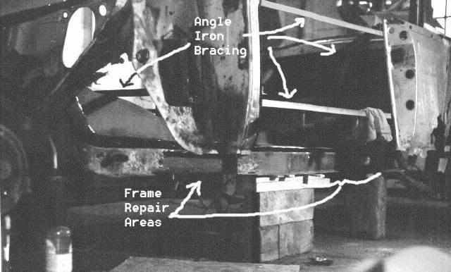

              I don't know how similar to a K body hardtop this is but the rear qtrs bolt on in a similar fashion so I'd say the design of the structure is close.
              I found when I pulled off the rear fender on my K the bottom of the inner qtr was pretty much gone. I have a better photo than this one but its not readily available for post so it will have to do:
              You can see the rust out on the bottom of the inner qtr at the far right edge of this picture taken from a low angle. This picture was when I was in the middle of fixing the floor and body mounts so those are gone too along with frame patching
              Any rate, when I got the new floor in and the inner qtr replaced I found that the top of the B pillar was quite flexible UNTIL I welded the bottom of the inner qtr patch to the edge of the new floor at the bottom. It stiffened up considerably when secured to the floor at the bottom.
              You say the inner qtrs have been replaced, so I'd look to see if they were welded to the floor at the bottom or maybe the edge of the floor has issues down under the window regulator. Maybe hard to get a good look at this w/o pulling off the fender?
