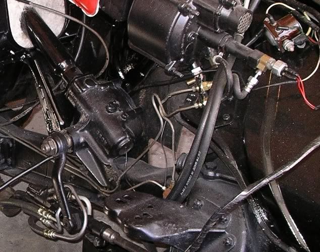

            Just be careful to attach the hoses in the right location. If you swap the location the braking system does not work when the vacuum increases. Here's a picture of my hydrovac in my 64 Hawk before I installed my engine .
            I wish I had a better picture for you.

                Looks like one of the lines leads down from the hose bracket and connects to another object than leads toward the back. The other line just leads to the back. What is that object the line is connected too?
                  One line IN to the hydrovac from the underfloor master cylinder.
                  One line OUT of the hydrovac. It runs to a "T" fitting on the frame rail that splits out the front and rear brake lines.
