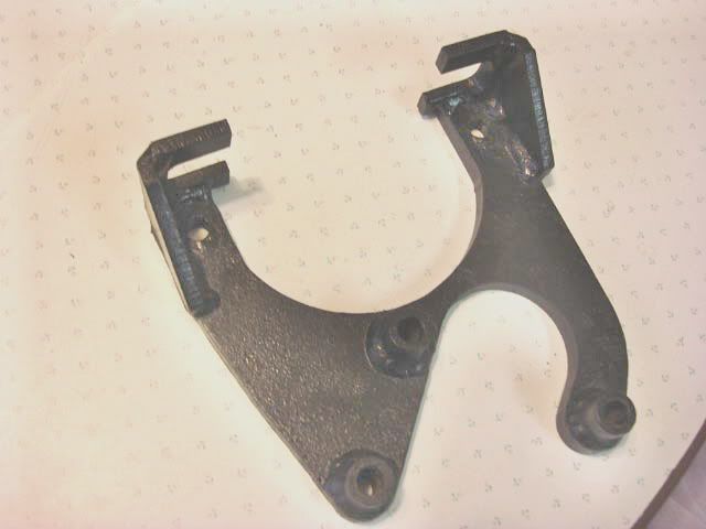

    Does anyone know if this was made for a 63 Avanti? Or what it is for?
    Allen
    Nope,
      Not anything like the brake mounting brackets on an Avanti. Dunno whether a vendor out there has fabbed something.
        They look well made but poorly designed.
          That puts 80's GM brakes on 51-64 Stude passenger cars.

              And remember that the bearings and rotor needed are different, too.
              This has all been done and scienced out (with a much nicer caliper mount bracket) by Jim Turner already.
                Alan,
                Do you know what type of hub and rotor would be used with the adapter?
                Allen

                        EDIT: that looks to be a rear caliper mounting bracket.
