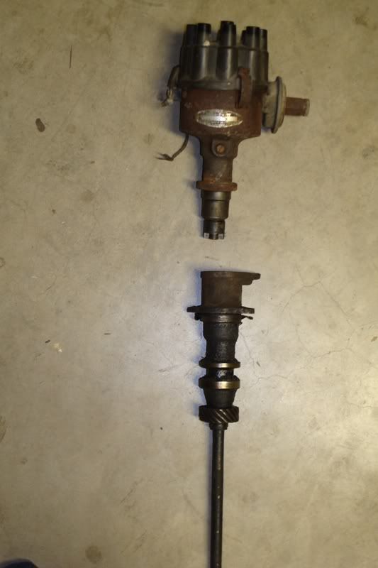

      quote:Originally posted by Tom B
      the 51 and 52 V8s had a two piece distributor drive, but have never seen one.
      Tom Bredehoft
      Tom,
      Dug out a '51/'52 distributor and snapped a pic:
      Paul

              Thanks, Paul. I can't imagine engineering approving of that design. I hope all existing got swapped out for 'modern' ones.
