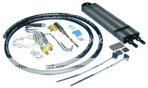

          quote:Originally posted by jlmccuan
          John, I'll be testing out one of the dipstick coolers in the next week. I should be able to get temps of both the SC case as well as the air charge temps with and without the cooler. Although this information will not give direct evidence of extending SC life, one would think that if the dipstick cooler does in fact reduce the operating temp of both the SC and the air the SC delivers, it would be a good thing.
          Jim,
          I found a picture of a dipstick cooler for Paxton SC by a company called JC Performance in Grover Beach, CA. Is this the one you are trying out or something similar to it. If so I definitely would like to hear about your results.

            That's the dipstick and pump exactly, but my heat exchanger is different. The dipstick is the hard part, the pump is FLAPS available and a variety of heat exchangers can be used. As I said earlier, I bought one of the dipsticks, but I think one can be built for less if you're handy. I've been logging temps coming from the air charge and the SC oil temps and it looks as though the bulk of the heat is from the compression. Possibly, more heat is going into the oil from the heat of the air being compressed than from the mechanical operation of the SC. Probably why most SC manufacturers concerned with heat going into the engine use intercooling or aftercooling rather than trying to directly cool the SC. But it's still too early for any conclusions.
