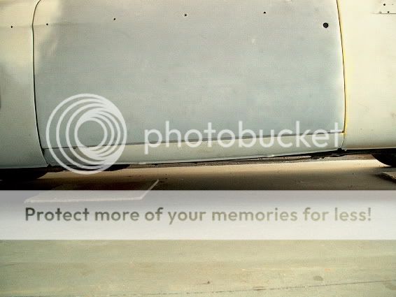

    My Hawk's rocker panels have a curve (bow) in them and I'm not sure they should. The door gap at the bottom is also a little larger in the center. I haven't seen any Hawks to compare them to. Is this how they should be - or should the rockers be straight across the bottom? They are otherwise in good condition.
    [img][/img]
    The C/K bodies are curved. The rockers are supposed to have a curve in them when they are made. If you sight along the bottom of the door you can see it. From the looks of yours, what may have happened is the rocker was made straight and then forced to fit the floor threshold (that is curved). I think that would tend to cause the bottom to bow down like it is. I suspect that rocker is a replacement....
    Is your hawk a C or a K ? The K's have a torque box behind the rocker that the bottom flange attaches to.
    I think you could rework this rocker to get rid of the problem but it may not be easy. You need to recurve it somehow the whole length as simply pushing it up in the middle may not work.

        My Hawk is a C-body so there is no inner support. I tried jacking them up and, as you indicated, that did not work. Maybe they were in fact replaced at some point, with panels a tad too long, or as you suggest, lacking the correct curvature. I'm just trying to decide whether to just go ahead and get replacements, rather than trying to get that bow/curve out. Do you know if the CE replacement panels have the correct curve? Sounds like some metal cutting is going to be in order either way... Thanks,

          Those rocker panels should be strait. My car still has the original ones and yet they are strait or bowed the other way.

            You should be able to see the rockersin this photo.

              Well, yours looks right, so obviously mine are not.
