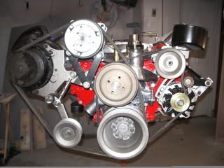

        I found this picture in my files. I don't know who the owner is, or how well it worked, but it seems that it has been done.

          quote:I found this picture in my files. I don't know who the owner is, or how well it worked, but it seems that it has been done.
          That would be the setup in my '53. I had to lose the mechanical fuel pump to make room for the alternator and raise the power steering pump. Further details in the "It CAN be done!" thread about two years ago.

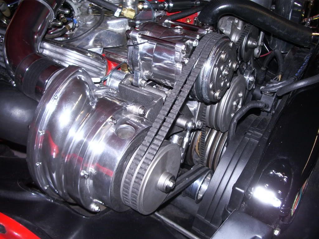

                  The first setup doesn't provide enough wrap on the blower or the crank pulley. The second is similar but the tensioner is on the back side of the belts and increases the wrap on the blower and crank pulley. Looking carefully I think they are the same engine but with the tensioner moved to the backside of the belts.
                  In any case leave the blower where it is and figure out how to mount everything else. If you can do it run one set of belts for the blower and perhaps a single belt for the AC, alternator and PS.

                    quote: The first setup doesn't provide enough wrap on the blower or the crank pulley. The second is similar but the tensioner is on the back side of the belts and increases the wrap on the blower and crank pulley. Looking carefully I think they are the same engine but with the tensioner moved to the backside of the belts.
                    That's exactly right. Ted Harbit pointed out the wrap problem after the 1st picture was posted, so I adapted a Mustang roller to push from the outside.
