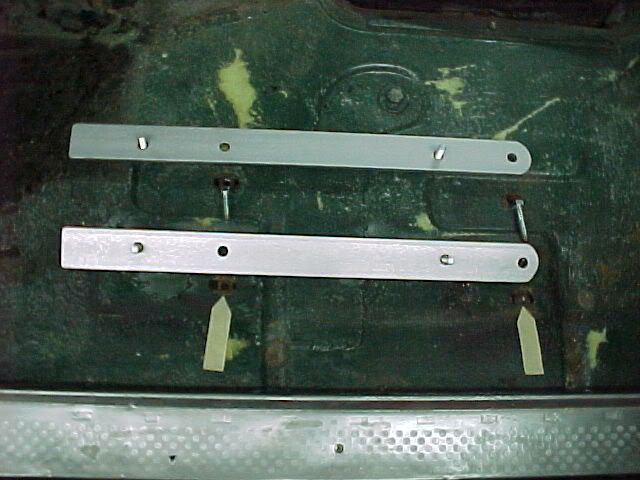

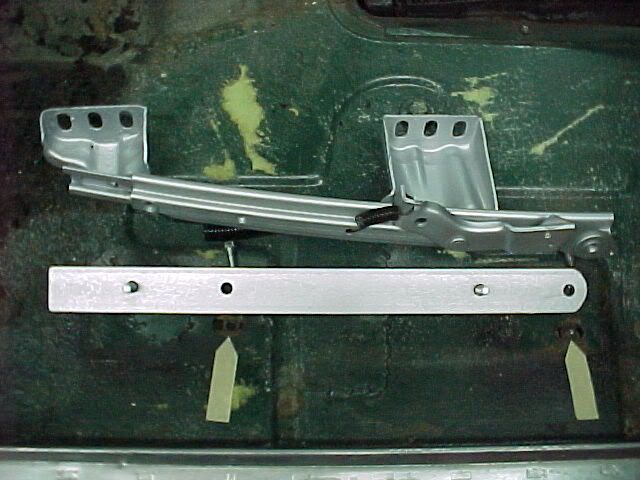

              I’ve got long legs so I do this on my Studebakers to get about 5"± of additional room. I’m sure it’s not the first time for this idea. This is just a display of how I get those extra inches.

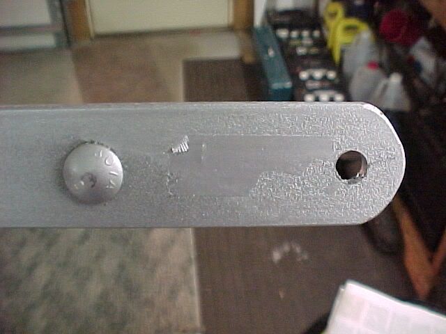

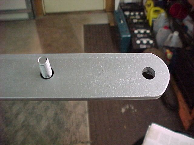

              I use a piece of 1/4th by 1-1/2 inch mild steel cut at 18± inches each. I locate the holes in the floors and get that distance set. See arrows in picture. Then I locate two other points 3 inches back. I drill the holes to 1/4 inch after starting with a 1/8th drill bit and working up. Then I used a 5/16 X 1 machine head bolt as pictured. In order to fix the machine head bolt as it will be upside down once in place I just hammer or swege the bolt into the 1/4 inch hole. Wack it good and it will then stay in place and not turn. Now you put this piece, ‘bolts facing up’ on your floor and use your original bolts to fasten the bar to your floor. Then mount your seat frame onto the bolts that are now pointing up from the floor. You’ll have the factory 2-1/2"± plus 3 more inches and you can always adjust the seat forward if that is too much. Hey, Three more inches and no Viagra needed!

                    The metal strips 1-1/2 or even 1-1/4 wide by 1/4 inch thick would be readily available piece of mild steel from any big box home store or most hardware stores. A 36" length let me have the two 18" strips when I cut it in half. After drilling I rounded one end and painted them silver. Machine bolts from the same sources.
                    I'm not sure the holes are the same in all models of Studes. Of course now I have my seat installed and don't have a way to get the holes right again without removing my seat.....
                    Thanks for the compliment about buying something from me though. All in all this is something relatively easy to do, so give it a shot.
