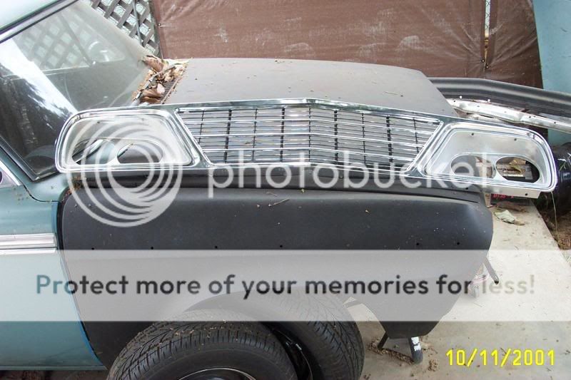

    A very simple process - just have to remember to cut a new tab for the inner bezel screw:
    Detail of 4 headlight grille
    2 headlight grille marked for cutting. Note area for tab. I used an angle grinder with a cutoff wheel.
    Most of the cutting is complete
    Speed nuts added to tab. Note that existing tab needed a new hole drilled.
    Almost finished. The bezel fits perfectly. I do need to go back and carefully cut some tabs in the bottom to hold the bezel better. The 2 headlight unit only has 2, the 4 headlight one has 4 - see first picture.

      I always thought that cutting and bending those lower two tabs would definitely be the hardest part, the rest is a piece of cake! let us know how you do on that task, when you figure it out.
        I'm going to cut the other tabs with a mini-cutoff wheel and a Dremel drill. The aluminum in that grille is harder than you'd think - bending the 2 new tabs might be difficult.

          One more pic - here's the grille with both sides done:
