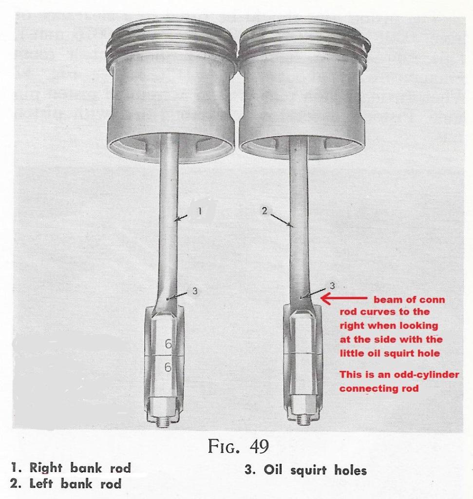

        Are you positive that you have four (4) odd side rods, and four (4) even side rods? You can't go by the casting number because both the odd and even rods were machined from the same casting. If you are unsure, this picture (below) will help you verify:

          "Are you positive that you have four (4) odd side rods, and four (4) even side rods? You can't go by the casting number because both the odd and even rods were machined from the same casting. If you are unsure, this picture (below) will help you verify"
          Yep, they look just like the picture.
          What am I missing here?
          All even ( like that #6 pictured ) then have the oil squirt hole facing down?
          I know mine are inverted from the picture and the holes are on the other side, but same as picture above.
          I thought all oil squirter holes were to face upward toward the cam.
          Input?

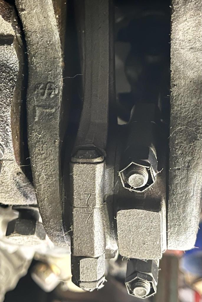

            We have two late 289 short blocks on stands stored in the shop with the oil pans removed. Both are low mileage engines that appear to have never been previously disassembled (standard piston bore, pal nuts on con rod bolts, etc).
            They're both as you describe with your engine. Con rod ID numbers are all facing downward. Odd numbered rods have the oil hole facing up towards the camshaft, even numbered rods have the oil hole facing down towards the pan.
            Number 7 rod, oil hole pointing up:

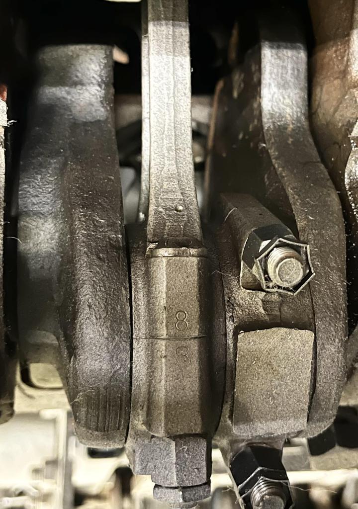

            Number 8 rod, oil hole pointing down:
            Click image for larger version  Name:	IMG_3057.jpg Views:	0 Size:	127.7 KB ID:	2032458
