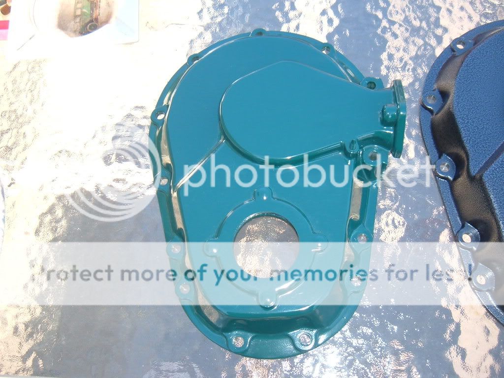

    As some of you know, I am playing with powder coating. I wanted to see how it held up under adverse conditions. The green one pictured below was done a few months ago and left out in the weather ( rain, snow cold, hot). The color has not faded a bit. Thr black one is actually silver vein, and the last one chrome. I am still experimenting with some of the more exotic colors.

    Powder coating is the way to go! I use the old oven out of the house and the parts come out really perfect. It is much more durable than paint, won't chip if you drop the part and th star washers only leave little dents in the finish instead of cutting out the finish.

        Where do you get the silver color? I bought a powder coating kit from Harbor Freight, but they don't have many good colors.
          Go to www.caswellplating.com. They have the closest thing to chrome that I have used. They are nice folks to work with.

            as long as it is under six feet long and some king of metal that will withstand about 400 degrees, I could do it in my oven.

              Google "powder coat", there are several suppliers out there that have really exotic colors. Columbia coatings is where I buy mine from, they have ceramic as well, water based and requires a 500 degree bake vice the 400 for powder. Columbia is about 2/3 the cost of Eastwood and has any color you can think of.

                  I was looking at Caswell's "super chrome" at $96 for 5 lbs, but it's polyurethane based. Have you used any powdercoats that were polyurethane based? And I see they have hi-temp powdercoats for up to 1,000 degrees. Have you used any of that on exhaust manifolds?
                    Noy sure and no. I'm not sure of the base of the Columbia Coatings powder. The water based ceramic looks just like the stuff on the hi dollar headers, will have to wait for a while to see if it will hold up. I put it on a friends manifolds, car is now blown apart for paint etc.

                      Been using Columbia Coatings for several years. Seem to be good people to deal with and they have a large variety of colors.

                        I am currently using their Extreme chrome and have had absoutely no problems with it. It flows out very nice and looks great.
