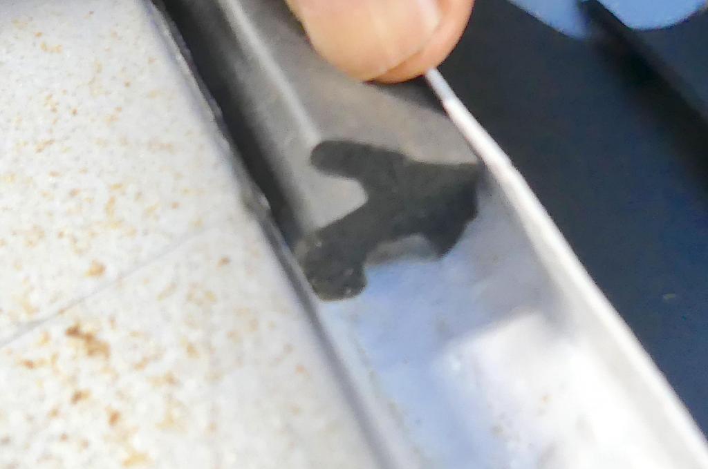

    I've searched these forums and know how the weatherstrip is supposed to go in the trunk. But the correct way has such small surface area for gluing, essentially two strips. And then won't moisture accumulate in the middle?
    Check out my pictures: The 1st picture is the correct way. If Ido it like in the 2nd picture, it gets a larger glue surface, won't collect moisture under neath, and has other channels to allow water to run off. Any thoughts?

    The Original did not have that open channel down the length and they DID rust out the Seal Channel, but I don't know if that would be an improvement over time, because the Seal Channel was not designed as a "Drain Channel" sloping downward like many Newer Cars do.
    On another note; looks like your "Correct" Picture may have the open "B" Side as shown in the S.I. Catalog Instructions facing Inboard, instead of Outboard as it should.
    Because both Pics are so Zoomed in, I really can't tell for sure which is Outboard.
      Sorry about pix, StudeRich, the rust side is the outside, so both are as intended. Maybe the center groove prevents rust and that's why they changed it? I may just do it the wrong way out of curiosity...
