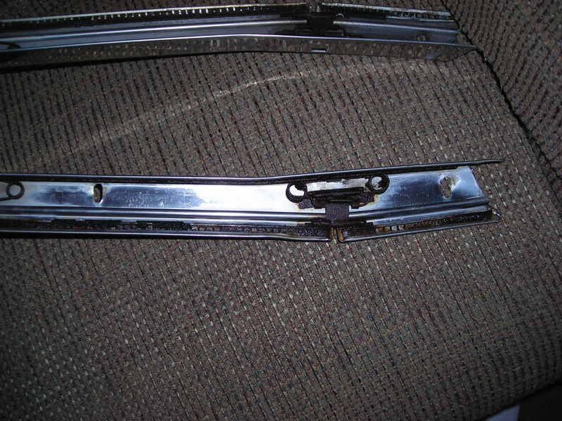

    Has anyone put new Cat whiskers in these? And do you have a how to instructions? This does not look like fun at all.
    Let me know thanks Anne

      It definitely is NOT fun, but refer to Lark Parker's series on stainless repair in this forum. I made the little tool to open up the crimped edges, which helps to minimize the damage to the front side.

        Anne, the little levers that stick out from the two sections of the flippers that are hit by the door window to close the flippers are critical and must be coated with plastic coating to hit soon enough to make it all work. I think I can see yours, (levers that is! [:I])in the pic and they look BARE!
          quote:and must be coated with plastic coating
          I bought a pair of these in '94 at the swap meet at the Int'l in MN. One was NOS and had/has a plastic piece on it like Rich mentions. The other was a good used one and did not. I seem recall the '53-'58 body parts book calls out that a change was made to these and the earlier ones had a rubber cap on there and then it was changed to the plastic. My guess would be the rubber caps were falling off.....
          I got some heat shrink tubing that was large enough and built up a "cap" with that. I think 2 layers. Holds up a lot better than black electrical tape.
          These things are a royal pain to try to get working properly. I've never been able to get the driver side one on my '53 to "snap" like its supposed to. I've spent hours adjusting it and adding/removing washers and shims to no avail. I figure as long as its not getting hit by the door I am doing better than some [^]

            Beware of the new replacement flipper springs. They are VERY stiff, too stiff actually and will distroy your flipper. I talk from experience. It happened to me last year. The rivets of the brackets that hold the springs in place are riveted to the outside SS side of the fipper and just ripped the rivets through their holes. I had to get the entire flipper replaced. Now I have heard that if you take a torch to the springs and heat them up, it will eliminate some of the stiffness. I don't know this for sure.
