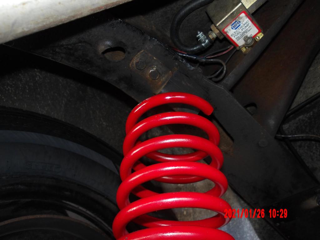

            i already have an e-pump at the rear of the car, perhaps get a higher pressure to replace, but don't the lines need to be high pressure capable?
            additonally don't i have to install a bung on a down-pipe to sensor o2? frankly I don't know the difference between HFI vs EFI
            what are the estimate cost associated with the implementation of these systems?

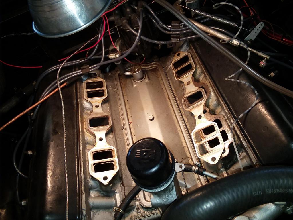

                  we'll i took off the manifold and i stuffed the heads with aluminum foil but the right side had a pipe from the manifold so i had to stuff the manifold around the pipe ( the easiest induction system R and R ever)
                  but
                  the car started spitting out bits of foil , when i put in a single sheet, and the car felt like it had an exhaust obstruction , am i suppose to stuff the heads or the manifolds?
                  i am trying this stuff first , I called HFI , nice fella, it's 1400.00 bucks I may need to put off for later Click image for larger version  Name:	20210223_135634.jpg Views:	0 Size:	117.0 KB ID:	1881892 what is with this tube, if i get an R2 gasket do i cut this off?

                      Lot's of idea's here.. Some good, some..Well..
                      Here's what I do. Here's what I sell. Here's a source..
                      Myers Studebaker in Ohio sells a nice AFB 4 bolt hole heat insulator carb base gasket.
                      You will need to trim the GM a/t kickdown tab to use this carb without an adapter. See attached pic) (my preference).
                      I do not recommend bending the tab. That throttle shaft does not tolerate abuse.
                      I sell composite intake gaskets that have no heat crossover passage holes in them.
                      Sell the intake gaskets as a kit. The kit includes a pair of gaskets, two very thin stainless steel block-off plates that get sandwiched between the intake gasket and the head. These protect the gasket from getting torched by the exhaust pulses.
                      The kit also includes four stainless steel carb studs and four stainless steel nuts (short on nuts right now. Awaiting an order,
                      OK, so much for the sales pitch...
                      Foil in the intake heat crossover is not a good choice. Neither is ceramic. Neither is filling it with molten aluminum.
                      The exhaust gasses are almost hot enough to melt aluminum and the pulses will chip away at it.
                      Yes, you will need to block open your heat riser valve (a 10-minute coat hanger job).
                      You can also take the blade out (a pita).
                      You could gut it, remove the shaft, tap the shaft hole and install a pair of bolts. All viable solutions.
                      This is a reasonable upgrade. Don't overthink it. I have done close to 300 of these 2bbl AFB conversion intakes.
                      Lots of happy owners out there.

                        i am completely lost, so you say my problem, is so prevalent that you have put together a "kit" that comprises of Composite intake gaskets? what is your company and how much do you charge?, do you have a web page and some pictures of this "kit" i would like to order it, but do i need to by the myer's insulator, or can i go with something else? and can't i use my studs and nut?
                        there is now fel pro metal gasket in there now
                        and someone said R2 gaskets will not have the exhaust holes in them, and another said they will have a 3/8" in hole in them.
                        do i even need to cut the kickdown tab? look below seems to clear fine
