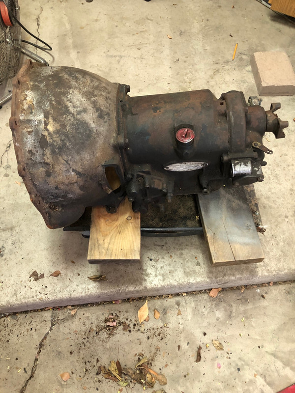

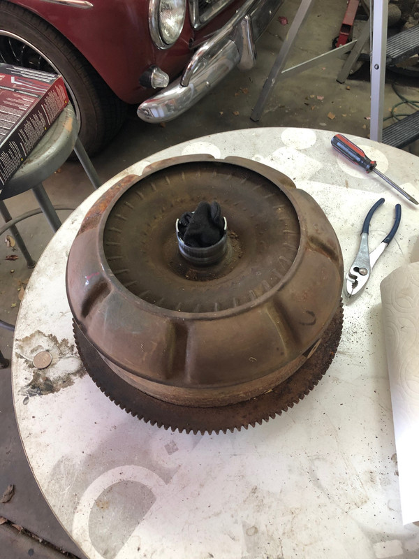

Now that I have decided to pull the DG200 and replace it with the DG250 I need a little help. I have read the manual and overall I understand how to pull it. I will take it out from the bottom. Does the batwing need to be removed for this? If it does I will have to pull the exhaust also since they welded all the pipes together from the manifold. I assume that I will have to pull the entire transmission with bell housing. Can I unbolt the converter and take out just the rear section then go back and unbolt the bell from the engine and take it out? Anything else I should lookout for?
I included pictures of the DG250
