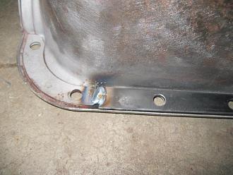

    I agree! It took me an hour to remove the engine in my Hawk, and an hour to put it back. It was a bitch to replace the pan gasket even with the engine out and upside down. I can't imagine trying to do it in the car. Besides, it gives you the opportunity to clean and paint the engine compartment, and engine. Also, while its out you can remove and replace the core plugs (freeze plugs) and clean out the water jackets; I got a quart of crud out of mine. I used brass Ford small block replacememt plugs, they were cheap. I also used a sealer called "The right stuff" for the pan, it was recomended here and is great, but very messy, and not cheap. While you have the pan off, it's a good idea to straighten and reinfiorce the flange. I used 1"x .125" flat bar. It's been a year or two and no sign of any leaks.
    Click image for larger version  Name:	IMG_0833.JPG Views:	0 Size:	138.2 KB ID:	1830381Click image for larger version  Name:	IMG_0835.JPG Views:	0 Size:	104.8 KB ID:	1830382
