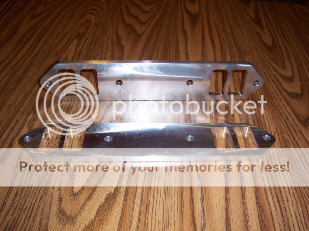

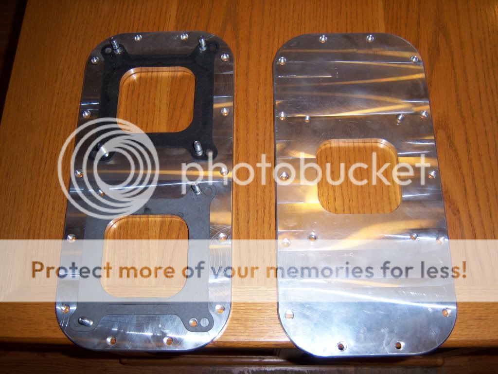

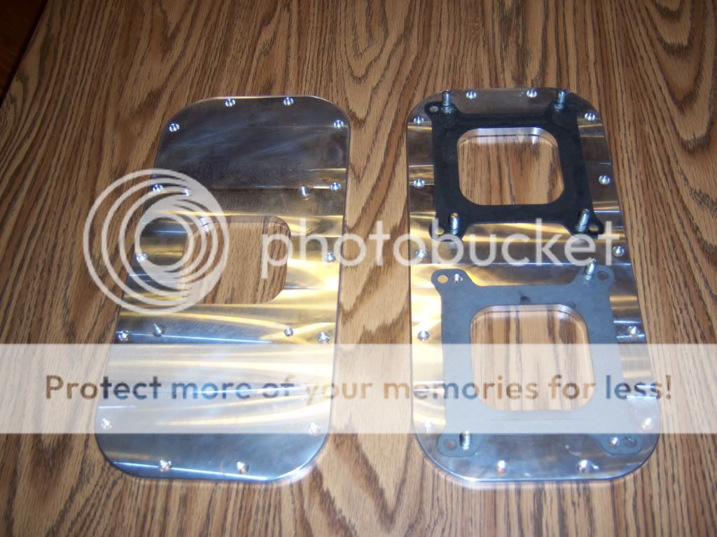

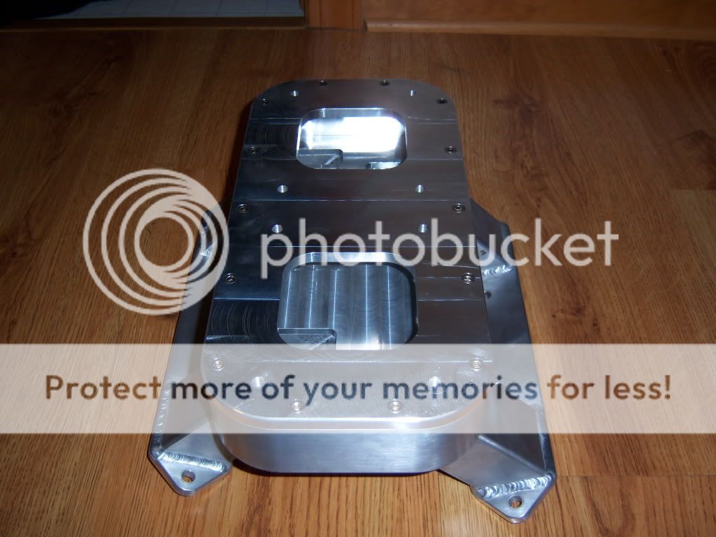

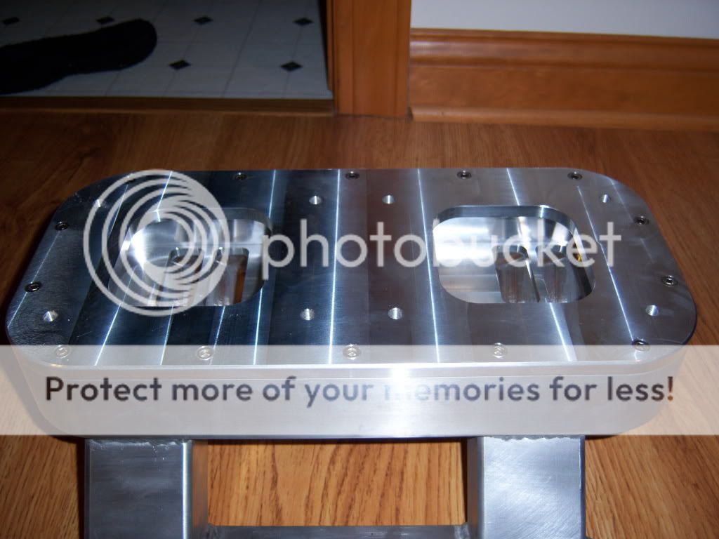

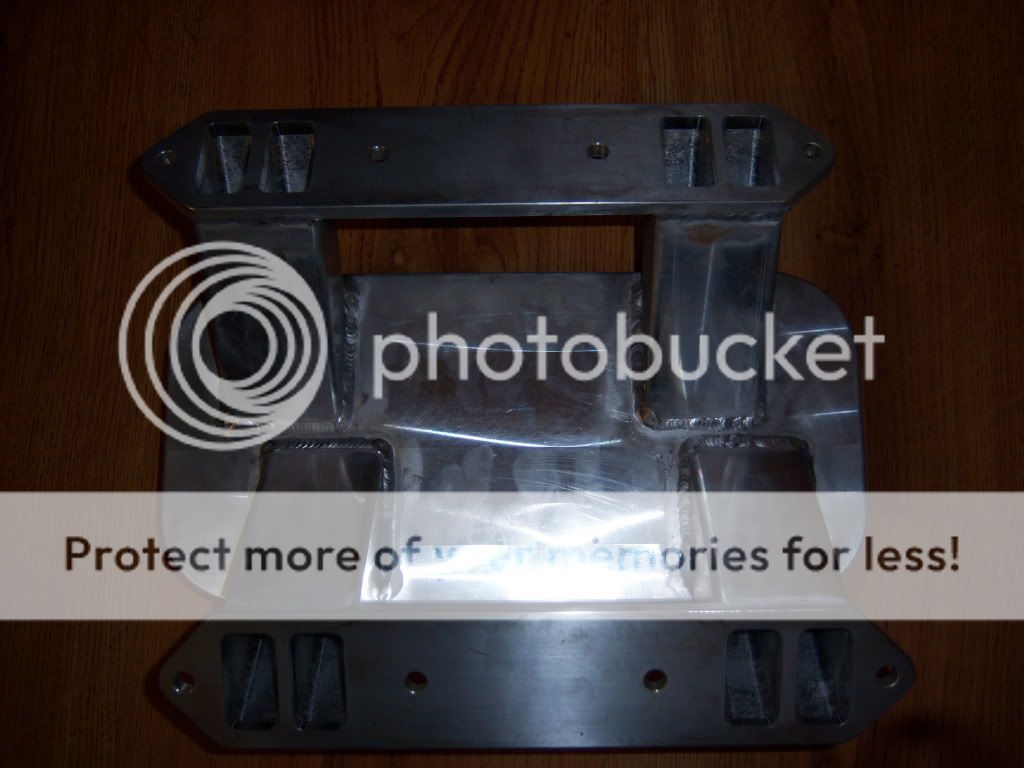

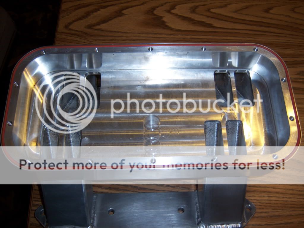

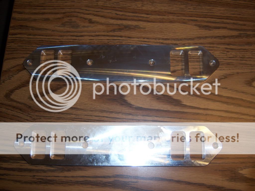

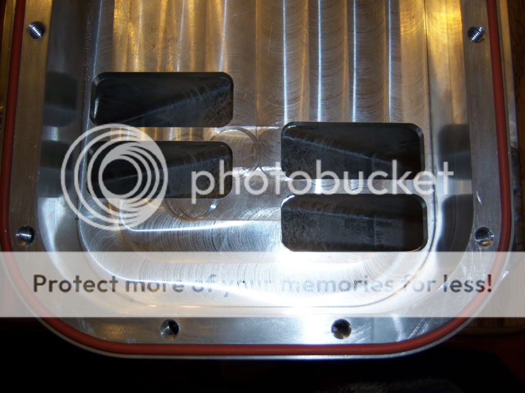

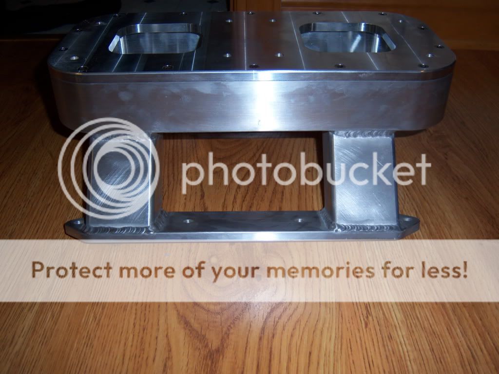

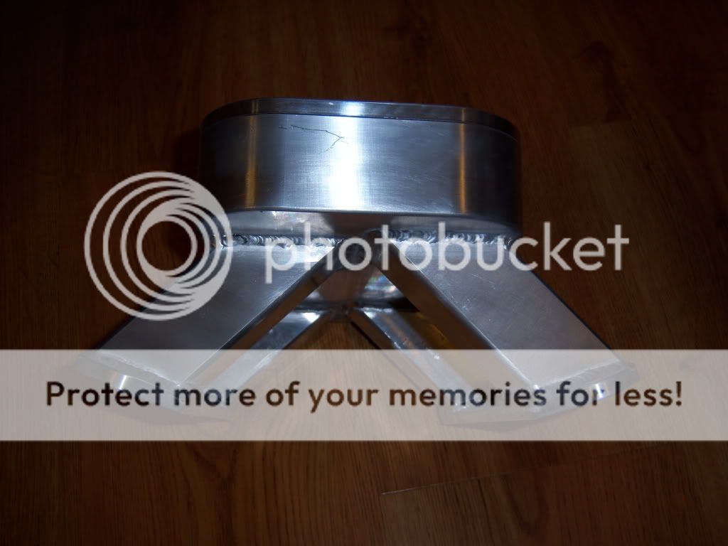

    I WILL BE MAKING THESE IF THERE IS ANY INTEREST.YOU CAN BUY THE INTAKE PLATES,OR THE WHOLE INTAKE WITH YOUR CHOICE OF A TWO OR ONE CARB TOP PLATE, THEY ARE MADE OUT OF 6061-T6 BAR STOCK THE RUNNERS ARE MACHINED OUT OF SOLID AND HAVE A WALL BETWEEN THE PORTS,LET ME KNOW IF THERE IS ANY INTEREST IN THIS NEW PRODUCT. AND THEY ARE MADE IN MY CNC MACHINE SHOP. THANKS KEN EVANS

        I FORGOT THE PRICES, THE INTAKE PLATES ARE 95.00 PER PAIR AND THE INTAKE IS 780.00 COMPLETE. THANKS KEN

            The fastest 259 I ever saw was a Lark with a homemade tunnelram. They work. Not for any sort of "street" application, but this intake will smoke anything else out there on a true race car, crummy Stude heads and all . . .

                  THE INTAKE IS 5 1/2 INCHES TALL KEN

                      Hey 53 Stude,that is BAD AZZ!! I am wondering could those runners be shortened in height and a top hat be made to mount a little 142 Weiand supercharger??? I have a Weiand on my 400 CI Belly Button motor in my 61 Lark,but allways wondered if a stock Stude 4bbl could be modified to accept the little blower.Your intake looks to be a much easier and cleaner starting point to acheave such a thing.Think a nice 289 with a small huffer=R5??!!?
                      Would that o-ring around the intake box hold 5 to 7 PSI of boost? I know I am bench racing here,but IF it could be done,say runners 1 inch or so tall,and a intake box uncut or tapped,what would that equal in cost.Would shortening the runners screw up the angle of the runners too much?How high are they in the picture?Hood clearance is a moot point,but how far the intake-blower combo sticking up would earn "obstructed vision" tickets,but would be SCREAMING EYE CANDY! A roots blown 289 would be a bad motor for a Studebaker Gasser,but a 471 or 671 would be a more period correct choice over a smaller,modern huffer. Wish I were independently wealthy!!

                        Good idea....and sure it can.
                        Yes, the o-ring will hold up. The same basic dseign is used on drag race engines that see over 40lbs of boost.

                          Looks pretty cool but i dont think it would work well on a street car. Those are long runners and look to be a fair size. The runners also look fairly smooth which would offer poor fuel adomization at lower rpms. But it should looks like it would be a lot of fun on a drag racing studie!

                              Those runners are actually much shorter than a stock manifold!!
                              AND they appear to me to be about a stock sized cross section.
                              Smooth...yea, but that has nothing to do with atomization, that comes from above! The carburetor. But fuel can fall out of suspension at low speed in a short runner like that.
                              With a single small carburetor, that manifold can work better than/as well as, many other manifolds currently available for the Stude.
