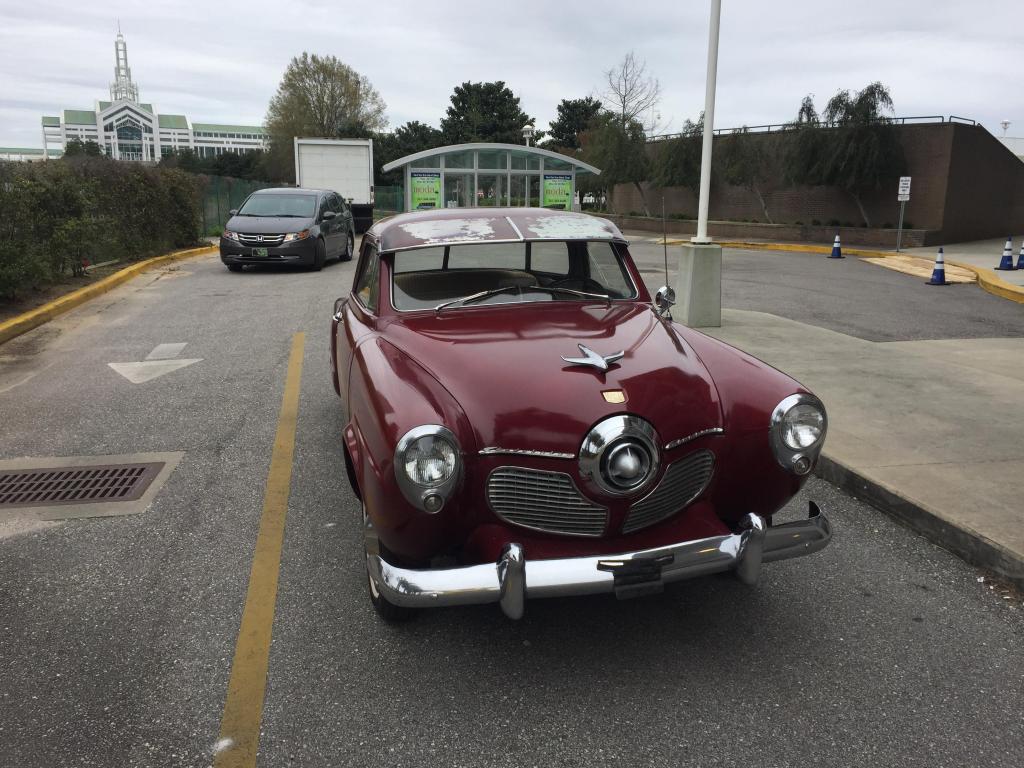

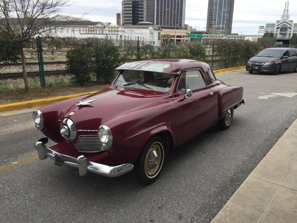

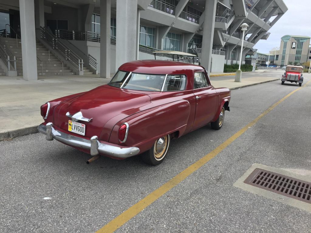

I've had all brakes, wheel bearings, rear axle, transmission, overdrive checked but can't locate the source of the roaring. The strange part is that the roaring stops when you put on the brakes. Checked to see if a shoe dragging but nothing shows up, it's got to be something like this I'm thinking. It's a 1951 Champion with hillholder, I've had brakes rebuilt but had another person check to see source of roaring and couldn't find any problems. It will do fine for first say 5 minutes then begins the roaring. Any ideas are appreciated as I just don't want to break whatever part. The person looking for the problem said the kingpins are very loose and that could be the source of the roaring, does that sound possible?
Roaring starts about 5 minutes into driving - stops when i put on brakes?
