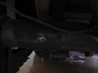

      5)We're embarrassed to say we don't know what or where the vent is. Can we get some help on that one? Thanks!

        Don't feel embarrassed about that lots of people don't know that! And it is very hard to find.
        You scrape (or wire brush) the top of left axle tube (drivers side) and somewhere in the center of the distance between the Diff. and the brake backing plate just slightly to the rear of straight up, you will find a small pinhole which you can clean around it and insert a finishing nail or straight pin into.
        I would guess that this was not an exact spot (requirement), just the most common! It could be straight up, or a little left or right of center. [^]

              If this the vent? If so, it's clear after scraping all of the garbage off of it. If not, we have a hole in our axle tube...

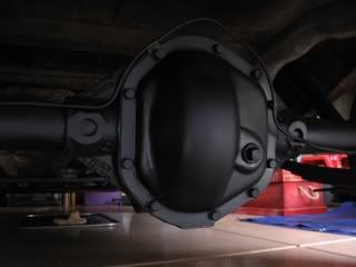

              Here is the end result after we got some paint on it. All we had was flat black, but figured that would do for now to keep the rust at bay. We're happy with results. It looks nice and clean and still no more leaks. We still need to take it for a drive to see if the leak shows up again then.

                If I remember correctly from your blog, you also have a transmission/rear engine leak. This could easily be the source of the oil on your differential. If not, following your trials and tribulations on a fairly regular basis, I suspect the pair of you could replace either the cover gasket or a pinion seal with a little instruction. And by the way, the reflection of your truck in the moon hubcap of the 1947 City of Phoenix garbage truck orange M5 is beautiful.

                  Good grief, that thing belongs on a TANK, not a Studebaker! [:0]
                  What do you do with those little hollow inside hex stud and nut thingys! [:0] Must be to mount your Turbonique Jet Turbine Engine!

                  I think those are supposed to be bearing cap supports. once the cover is installed, you tighten those down and lock them in place so that the cover is bracing the bearing caps.
                  And yes, I want one of those covers. Not that I have enough torque to be breaking internal rear end bits, but it just looks cool. Shiny. And cool. Would look better if it were fully polished, though. The fill hole is awful high on that one though, must be a high-pinion 4x4 part...
                  Have I mentioned that I have a near crow-like obsession with shiny things? Especially shiny car parts.
                  Oh, and John and Tracy - that rear end looks much better now. Only thing is, it kinda stands out next to the rest of the underside of the truck, doesn't it? Guess you have to detail the rear springs next. But once you do that, they'll stand out next to the frame. And then...

                    Just so you know that rear cover is really simple to remove/replace assuming its like the ones I have done on cars(I believe it is).Just unbolt it,clean everything,new gasket and sealer,bolt it back up and add fresh grease.The pinion seal is a bit more complex but still an easy repair(airtools are priceless to remove the pinion nut).Once you find the leak let us know and someone will walk you through it.Best of luck,Steve

                              Just a reminder, Primer paints do not seal out moisture, so double check that flat black. If it was primer, hit it again with flat black enamel. Otherwise, you're lookin good.
