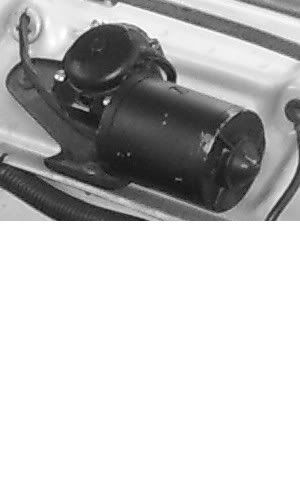

    Newbie here, looking to replace this wiper motor (power in but no movement)
    Does this look like original equiptment??
    Best place to buy a replacement??
    Thanks
    hmmm, 54 grease in the transfer case can get pretty thick, even solidify. Have you opened it up to see? You have to remove the motor from under the dash, after disconnecting the struts that provide the wiper movement. You can disassemble the motor to see if the brushes are still good. If you need new ones, a local vacuum cleaner shop may have something similar.

      You could have a very common problem with these. Remove the top cover over the "Parking Switch" a few current tests should determine if it will run bi-passing the switch.

          Thanks for the info.
          I forgot to mention, electrical updated to 12 volt & SNAP wire harness.
          I guess I was hoping to replace with a remanufactured unit & use this one as a core.
            Tim,
            any wiper motor from a Hawk with three wires coming out of it will work, either Autolite or American Bosch. One with four wires will not work with your original switch. I think most are three wire.

              I just went through this on my 55 Commander.
              After taking the motor apart and cleaning the brushes, then cleaning up the park switch it works fine. The grease in this thing was nasty.
