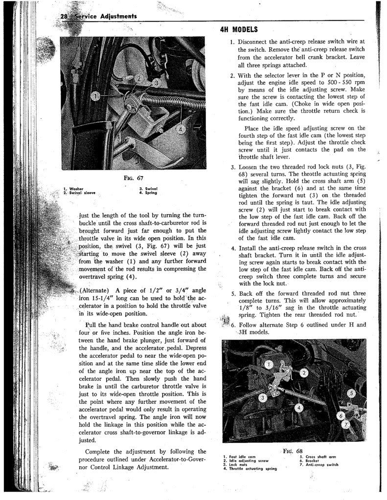

    Hi Dwain,
    Duh! Why didn't I look in the '54 supplement? Well, I was in the automatic drive manual so I could adjust the accelerator to governor linkage. I have the '54 supplement in front of me now. It's been hot here; maybe it's heat stroke. Guess I'll turn the a/c units on in the garage now and get back to work.

    I think what you're looking for is in the '54 supplement. If you don't have that booklet I can scan the page.

    Hello Group,
    I'm in a bit of a quandary. Our automatic drive shop manual has instructions for adjusting the accelerator-to-carburetor linkage, but it doesn't cover 5H (1954) models. While some would automatically say that the adjustment is the same as 4H 1953 models, there was a bit of a difference between the carb linkages for those years. Take a look at the attached image; particularly, look at Fig. 68. Specifically, 1954 model carburetors did not have the adjustable rod on the carb end of the throttle linkage. The spring from the cross shaft arm was simply attached to the carb bellcrank. So what is the correct procedure for adjusting this linkage?
    I need to make this adjustment before I adjust the accelerator-to-governor linkage.
