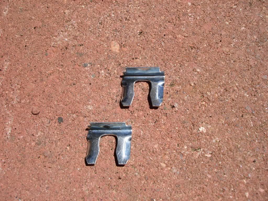

    I'm just getting around to installing my new rear parking brake cable (from Steven Allen)- took the old one off last year- it's been a bad winter around here!
    It came with 4 clips- 2 of them go on the frame brackets- do the other 2 go on the cable where it meets that piece that screws into the backing plate? I haven't come up with anything that looks right. This is on a 57 Hawk, by the way.

    "Clips" is a pretty broad term. How about a photo?[8D]

      Here is a picture of the backing plate with the Parking brake cable going in (sorry- a little bright for detail). The hold down clamp is screwed in all the way but the cable end can be freely pulled in and out of the opening (the cable hasn't been tightened yet). The other pic is of the 2 extra clips that came with the new cable. The brake end of the new cable is different than the old one- I'm wondering if anyone has used the new type- are these clips supposed to hold the cable to the backing plate? Unfortunately, I got it from Steven Allen so I can't ask him.
      Appreciate any help/advice.

        Looks as if you may not have cable in clamp properly. Can't tell from photo but may have to be positioned further in clamp. My 56 isn't here
        and I'm going from memory, though I do have a new cable with 2 clips here for reference. I switched rears recently and seem to recall being a little confused with placement of the ends on mine. If recollection serves me the positioning appeared incorrect until tightened and difficult
        to start nuts.
